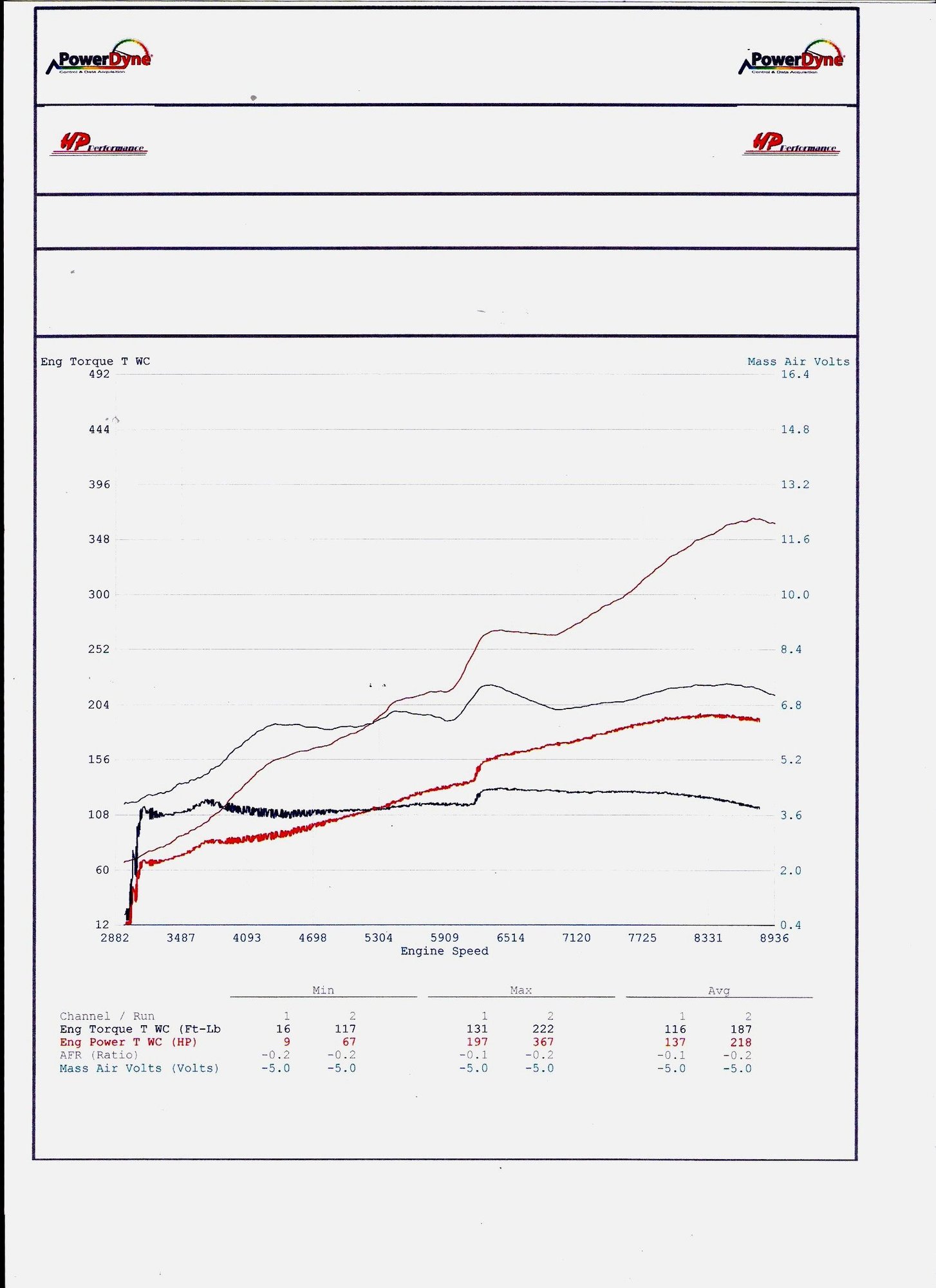

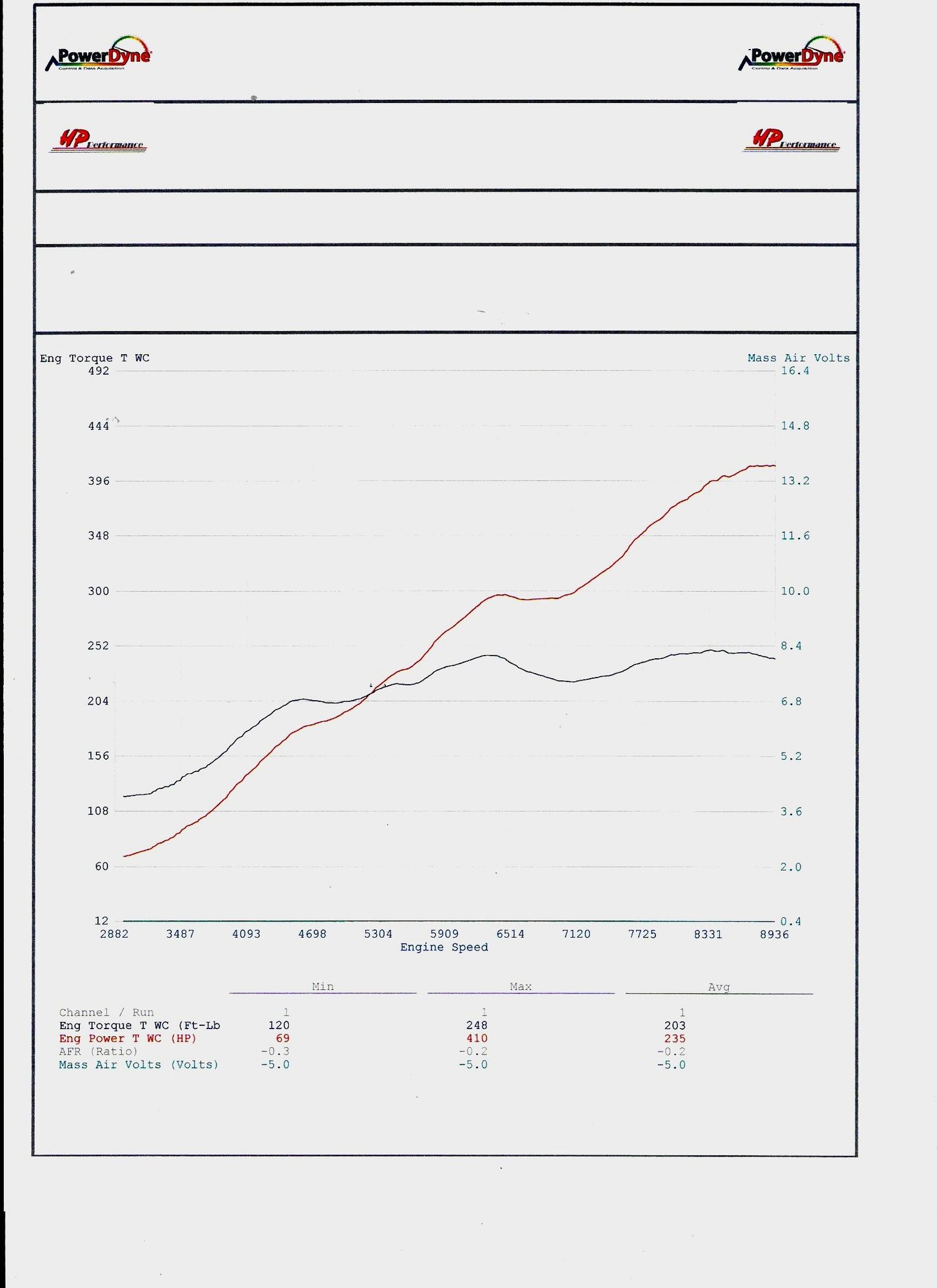

FYI, here are some dynos that Nathan emailed me.
stock, 9psi and 13psi with GT35r. Correct me if I'm wrong, I believe that the vtec was not moved for comparison reasons.
