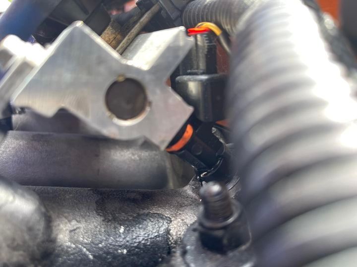

I have a small fuel leak on my fuel rail to injector between the rail and the injector, I have a TTS supercharger which was fitted by the previous owner.
Does anyone know what injectors these would be so I can order new seals? I believe them to be 1000cc. I
f there in the standard fuel rail assume normal seals will work? However is it a standards fuel rail?

Those are Grams 1000cc injectors (Bosch EV14 equivalent). Yes, that is a stock fuel rail and yes you can use stock injector o rings. Here's the important part: ensure that you lube the new seals before pushing them into the rail to avoid tearing them up.

Mine is a AP1 2.0 as its european, so i dont need GRAMS TOP SHORT 11MM ADAPTER?
was reading this thread. https://www.s2ki.com/forums/s2000-fo...-woes-1105129/

You should already have the top adapters there, what year is your car?
This should be for between fuel rail and adapter https://finjector.com/eng/viton_o_ri...e-p-476987-249
You got the Honda part number there as well.
This should be the correct o-ring to go between top adapter and injector https://finjector.com/eng/viton_o_ri...s-p-476986-249

I was studying earlier as my engine is in a kit car, looking at the rocker cover i believe it to be a 2003-2005 engine.
I got an injector seal set from Tegiwa hopefully that will sort me out.

03-05 use 11mm top injectors, but you might want to get a few 14mm ones as well while you are at it just in case.
