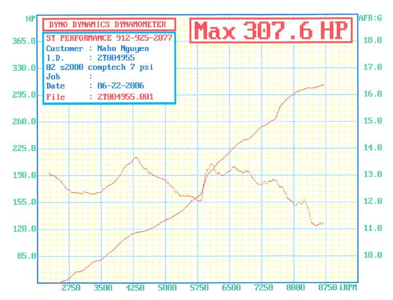

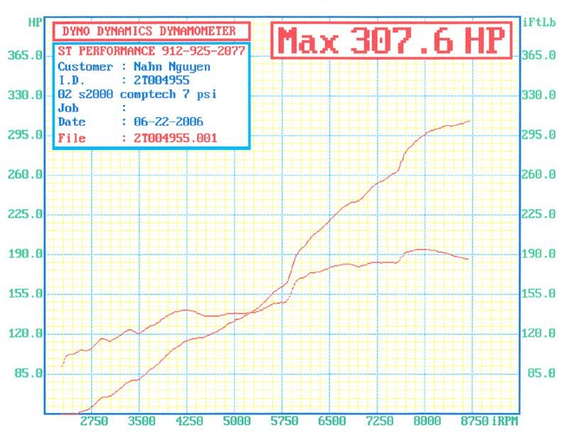

It was very very hot today, came out with 307, which i expected. Althought air/fuel ratio is looking like shit. I'm running the tech2 7lb pulley.. Any suggestions on what to do next guys? Do I need to twist the FPR a bit?

dont dynamometers dyno lower than dynojet? anyways nice numbers!

Not bad, a little rich at WOT, but if you are using a RFPR then there's not much you can do about it.

good numbers what are you using to tune if any?

Did you lower your redline or did he just stop? You might have gotten a couple more horses after 8750

Nice dyno. I think the guy mispelled your name on the sheet.

lol yea he did, i guess he stopped at 8750.. i'm running stock ESM right now, need to save up for AEM EMS

I believe dynojet is a brand of dynamometer. Just like dyna pack, mustang, ect.

Nice numbers kinda surprising.
