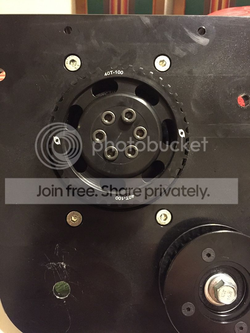

Over the weekend i went to get a tune, on the second to last pass we noticed smoke coming from the bay. Next thing we know, the pulley and blower is seized, we checked the oil and it was very low but still a little.

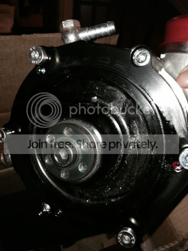

Decided to take the blower off my car to check it out tonight
This is what i found.
The shavings aren't metal, they feel more like rubber. Blower won't spin as well, anyone have an idea why?
Don't want to disassemble the blower, just incase it voids warranty.

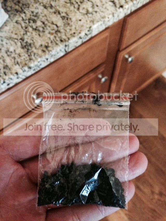

Not sure if this is the same thing ... but when my blower went, we noticed the following when taking it off:
This was a collection of the "rubber" that was found.
Yea the rubber shavings were like that! Did you ever find the cause or solution?

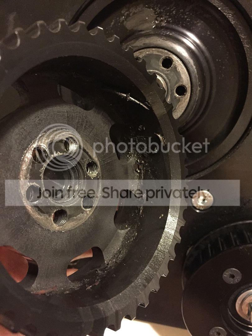

What's with all the galling on the pulley face and blower hub face? It looks like the pulley was moving against the blower hub for quite a while.
Rubber shavings almost have to be from the belt. I don't think a bearing seal would be able to leave that much material behind.
