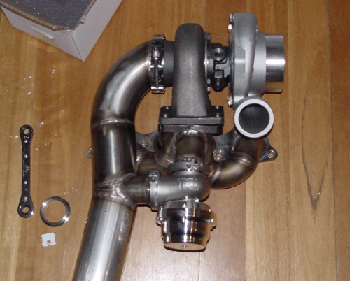

I thought I would start a thread about installing and running the LoveFab turbo kit.
My car is RHD so this was pretty experimental. That said, everything fits fine so far.
I have most of the parts ready to go and will be installing this weekend. I did my own IC and charge piping.

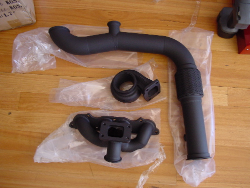

I have had my turbine housing, manifold and downpipe ceramic coated. I also had my manifold machined flat as it was warped.

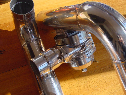

I am using a Turbonetics Godzilla BOV but am routing the outlet back to the intake for a quieter system.

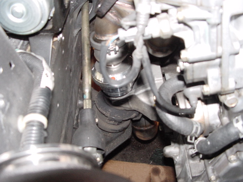

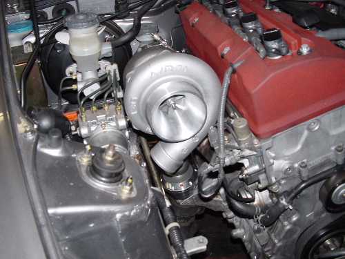

Liemoanh's kit is pretty much done... I helped install the manifold/blower/wastegate... fitment was a bitch!
The clearance on the wastegate side is like NONE.
I'll let him chime in.......but he's pretty much done. Last I talked, the mounting for the Intercooler didn't allow it to sit high enough...
I had trouble test fitting the down pipe to the turbo and wastegate but Tinker told me to loosen everything off (wastegate collar and turbo-manifold bolts) and it all went together fine. I expect I will have the same issue now that the mating flanges are coated and might dremel off the surfaces first.

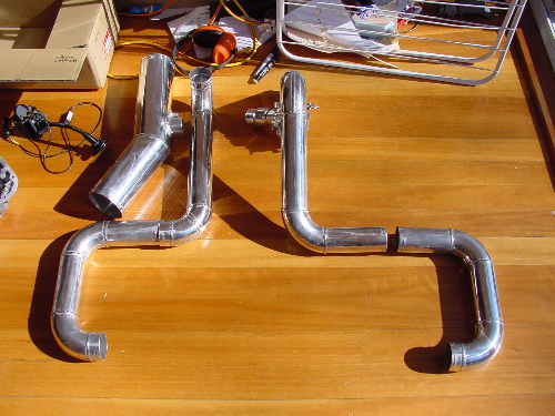

My intercooler is a PWR tube and fin 600x300x76. I spent ages making up the brackets from angle steel. It basically hangs from the threaded stubs at the top. The bottom mount just holds it out at the correct angle. The top of the IC is behind the bumper support. I may have to channel more air up to it. That said, I am very impressed with how well it fits.
All the IC piping was cut here and mocked up by holding it in place. Once I had the four sections worked out I strung them together on string and used a permanent marker to show which pieces joined to which and at what orientation. I then took them out to the welder and he spent 10 hours welding them together. I hope they fit. Most of them look pretty good by I think the pipe connecting to the throttle body will hit the bonnet. May need to be cut and angled.

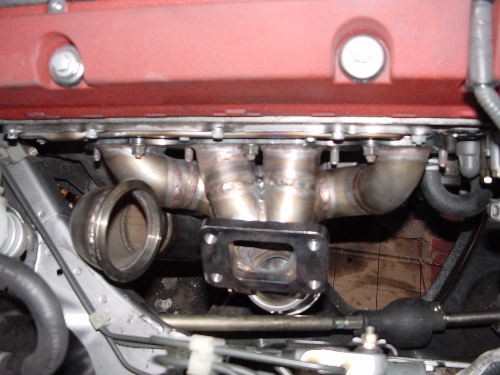

Just about to trip 13,000 miles since the end of January. As for the manifold flange being warped, its a natural tendancy when it pops out of the jig. We cut expansion slots so it easily bolts flat to the head, as well as to allow things to move without breaking/loosening head studs(experienced this during the first dyno session, was fixed directly after, has been since). Once the manifold gets hot a few times, if its ever removed from the head again, it comes off perfectly flat.
