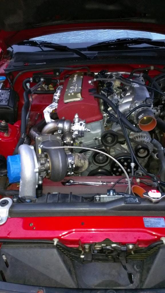

Made some progress today, but still have to mount the intercooler and charge pipes and button up a few of the other little stuff. Would have made it further, but had a couple of bumps along the way where I had to leave to sort them out. But, overall, its coming along pretty good and should be ready to go tomorrow

which manifold is that?

Synapse Turbo

does the wg hold boost fairly well?

Hopefully so, but I haven't got a chance to run it yet. I've had a couple delays that kept me from getting it going sooner. I'll be sure to update though. I'm hoping to have it tuned monday so I'll post up how everything goes. I do know they have a couple of high power cars running there setup though and Hondzla here on the forum runs it to. I think he's up over 600whp now.

Same manifold had no problem holding 10psi on my buddies s2000. Wastegate placement sure isn't ideal but it seems to work fine.

Looks good! Im hoping for 14-15psi on pump gas.

Here is my buddies dyno. We built it in a weekend, used the synapse manifold with a gtx3071r. This is 16psi of boost on a bone stock ap1 motor with 120,000 miles on it. 5 psi wastegate spring in the tial mvr using a MAC solenoid with boost by speed, no issues holding boost whatsoever.
