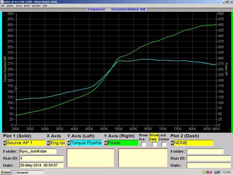

Stock Motor Tuned at 15 psi on 93 Octane yielded 453whp/295tq
