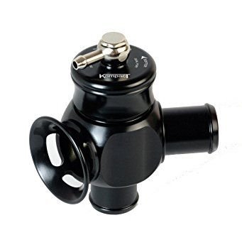

Found it, ordered the Turbospeed dual port valve. Seems straightforward.
https://www.amazon.com/gp/product/B001N21VIE/ref=oh_aui_detailpage_o01_s00?ie=UTF8&psc=1 https://www.amazon.com/gp/product/B001N21VIE/ref=oh_aui_detailpage_o01_s00?ie=UTF8&psc=1
