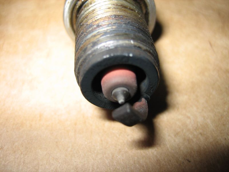

This is the first time I changed plugs since the s/c and its been about 1 year and a half. Not sure how they're supposed to look, but here they are. I replaced them with Denso Iridium IK24's. Feels a little better.

That plug looks not too bad. Might be a tad on the rich side but not bad at all. What's the gap you've been using? That gap looks a bit wide but hard to tell for sure in the picture.

I agree, the gap does look wide. In fact, it looks like a stock, non-supercharged plug gap. Otherwise, the color looks great.

Those are my stock plugs, never changed the gap for the s/c. The new gap Im using is .034, or as close to that as I could get.

This may explain the slight carbon (black) appearance around the ring. At high boosted rpm, the spark was being blown out and you weren't getting the best combustion.
