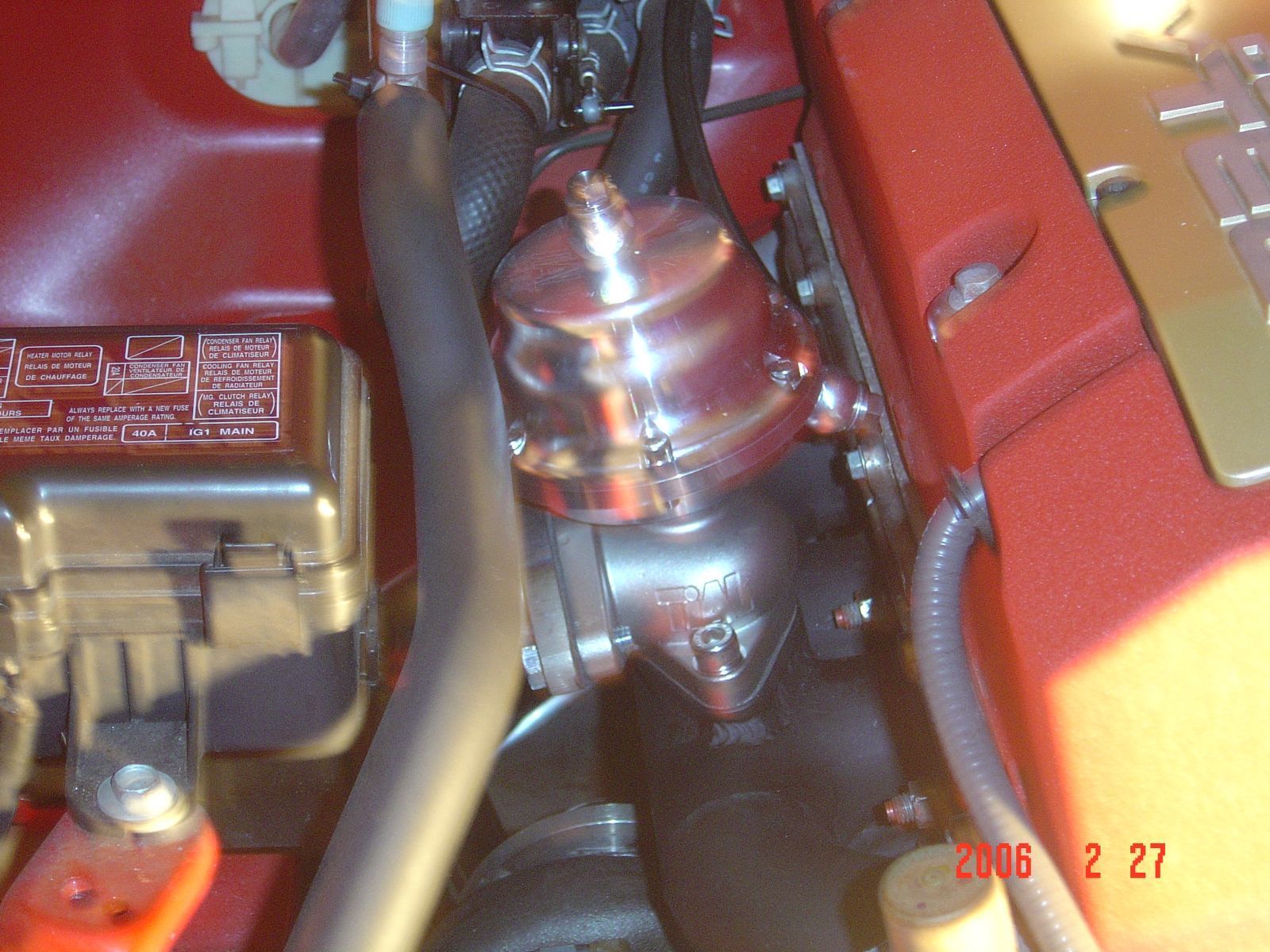

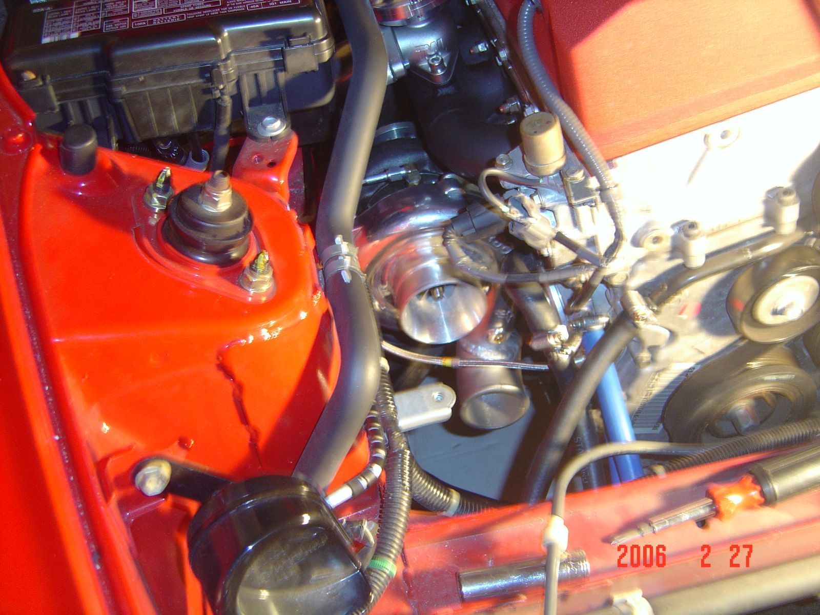

Do you have any more pictures of where the oil relocation area? On the UR website they show the engine bay shot with the factory heatshield in place. So it's possible to leave it on there with the kit? How come you are not running it?

I dont have any other pictures but I can take some if you like would like...? I tried using the oem heat shield but it didnt fit with this version I guess? I havnt had any problems with stuff getting too hot in that area and I just moved the heater core hose out of the way to be safe cause it was the only thing close to the manifold/wastegate. I've been running this for awhile and no signs of anything getting too hot in that are either.

I'd like to see more up close shots of the manifold/turbo area and the oil relocation pieces if you dont mind =]. Oh and did you have to remove/move/modify anything else for the installation of the kit? Thanks
Your fuse box will start to melt, Trust me.
Put some heat tape on it or something.
here you go..
