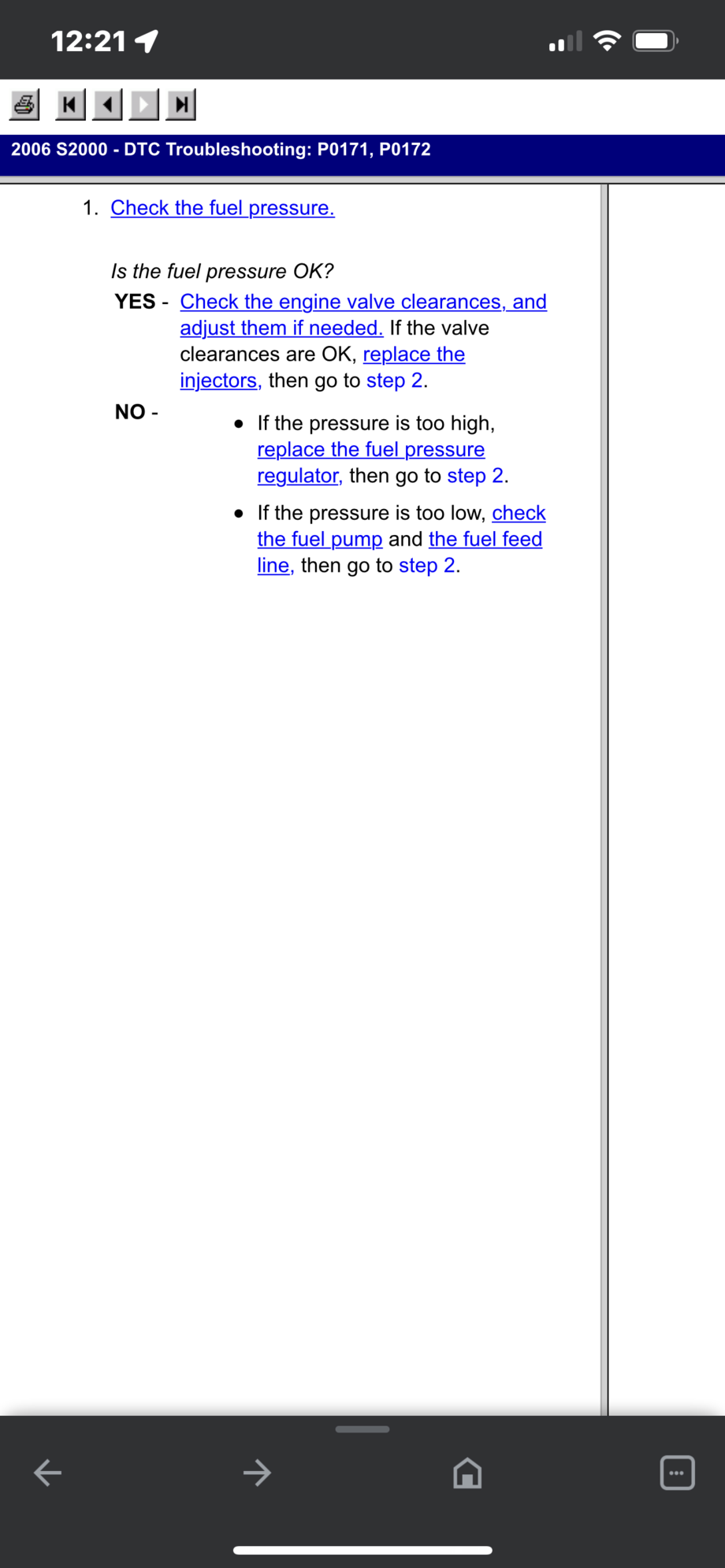

Per Honda, check fuel pressure. If fuel pressure is ok, check and adjust valves.

I was going to say, the fuel pressure is something you want to make sure is in the proper working range and not having a sudden loss during these running lean CEL's you are getting. Maybe there is an issue with the fuel pump or fuel pump wiring/related causing the intermittent issue. You want to rule this out. With only 9psi, the stock fuel system of the 06+ DBW should be adequate to keep up. The less aftermarket stuff you have to run the better. There was an issue with Chinese counterfeit Walboro 255 many years ago which didn't flow properly. I got one. Not sure if they are still floating around.
