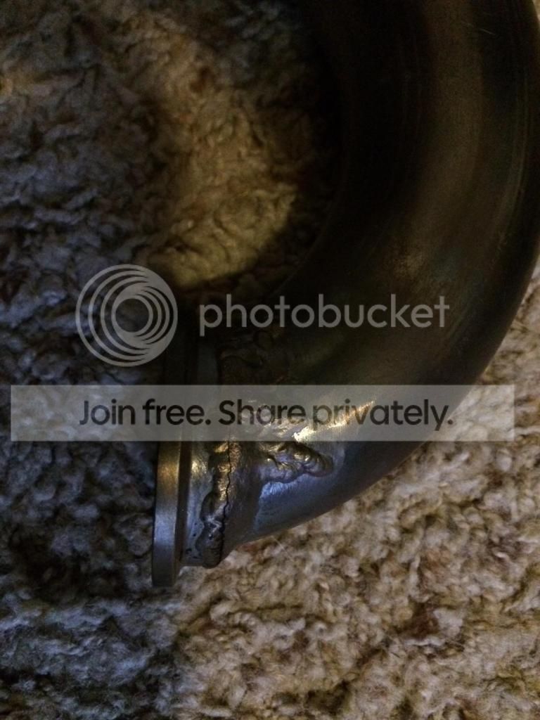

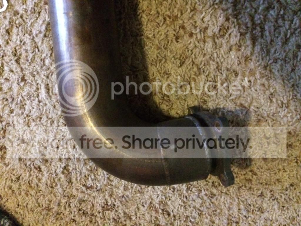

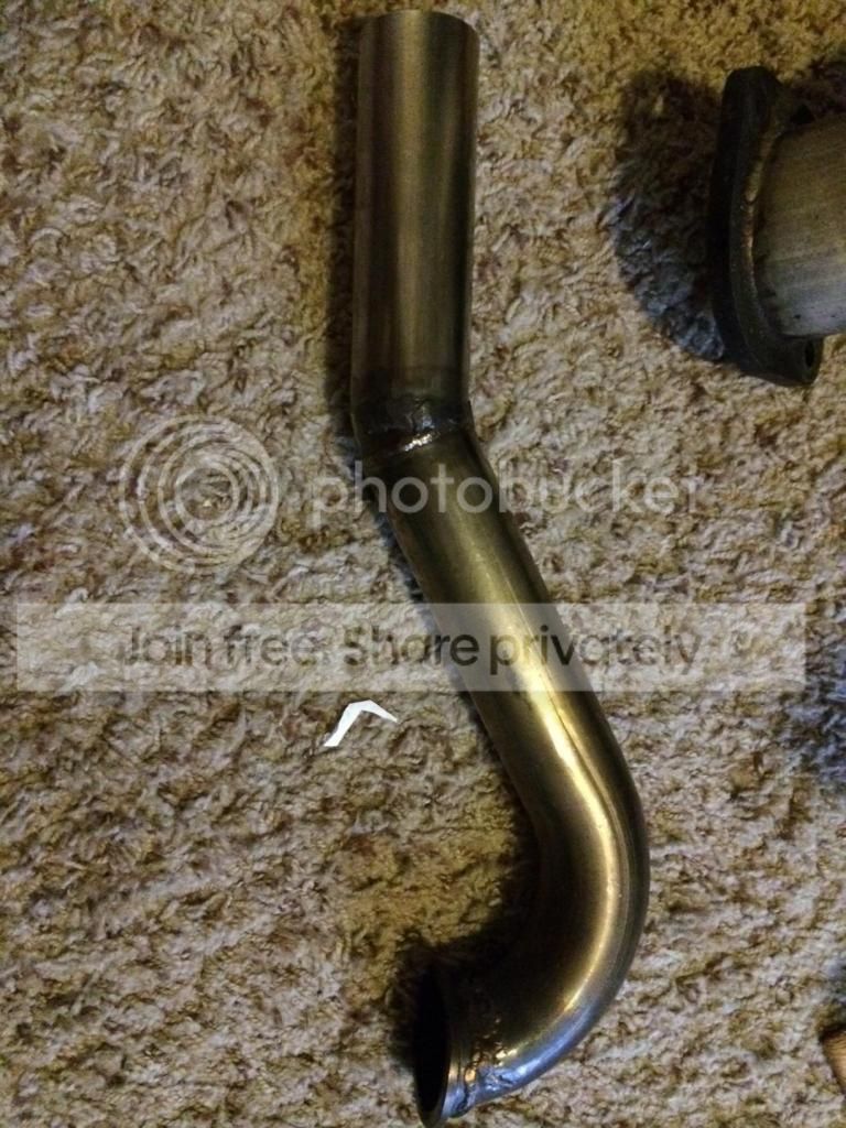

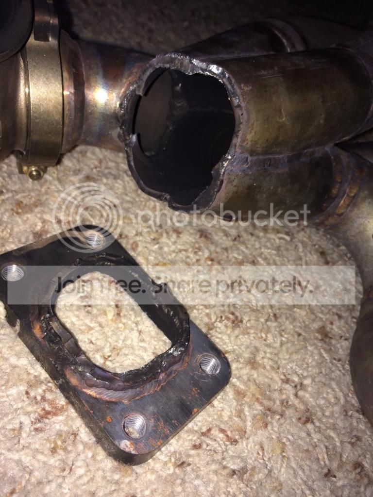

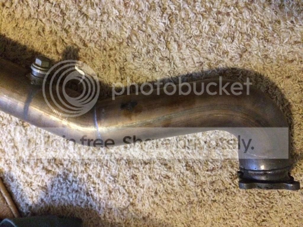

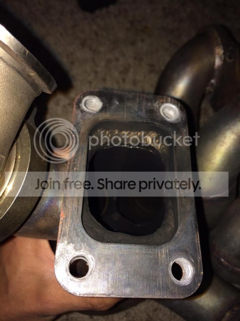

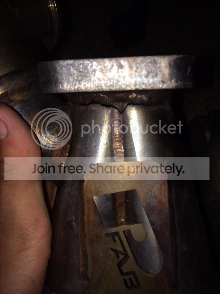

My PFab ELT manifold broke again and I'm just tired of messing with it for now. Pang offered me to return it to him for labor(I'm the second owner so I'm not covered under the warranty).. I think I might take him up on it and send in all of my parts just to see if he can make it fit better. When I first installed it the dump tube kept cracking as you'll see in the pics, I've had a local fab shop repair this thing about a billion times.. So Pang told me if my motor mounts are good this should solve the issue. My stock mounts appeared to be fine, but I replaced them with Megan/hardrace anyway. The motor is definitely A LOT stiffer now.. it barely budges, but the fitment of this kit is ridiculously close between the cyl 4 runner and the frame of the car. I received the kit with the dump tube clearly being modified.. if it's even PFab's original creation at all.. so maybe that's causing all of these issues.. I'm not sure. After I got the car tuned I was driving the 3 hour trip back and my downpipe literally separated from the turbo at a weld so I had to stay the night in a hotel in BFE Kentucky and have some local exhaust shop hook me up with a quick ugly weld to get it back on the road... so that's why the downpipe looks like shit.

This is what happens when the fitment of the manifold,down pipe and everything is not spot on correct. If anything is touching the frame or rubbing on something you have problems. Looks like you need a new manifold setup. I have dealt with a lot of manifold cracking issues before I can guarantee you that if you try to fix or reweld that manifold it will break again in a very short amount of time. You need a new proper fitting manifold. Ideally some thing made with schedule 40 stanless piping and not schedule 10. I would recommend a full race manifold if u want a solid reliable manifold that will never break.

Keep in mind I had this repaired locally before from a pretty crazy crack around the same area.. but the guy did a great job on it inside and out and cleaned it up/resurfaced the flange.. It held up for about 4000 miles after that (including two back to back 600 mile trips) but finally took a poop a few days ago during some spirited street driving.. lol.. I really wanna swap to a sidewinder, but I haven't seen anyone running the PFAB forward facing.. The sheepey manifold looks really nice and my buddy ran it with a vband collector, I'd obviously need a T3 one though... Oh well.. hopefully I figure something out.. Pang offered to fix this one but I'm almost positive it's going to continue to mess up no matter what gets done to it.
Look like pfap added some brace on the short side of the turbo flange
