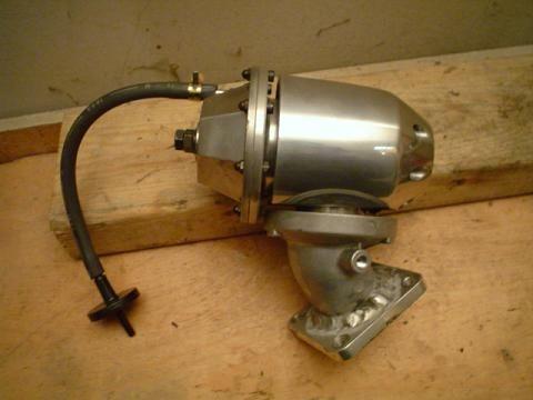

Took this out quite a while back, but here is the Turbonetics Godzilla on my Comptech unit.

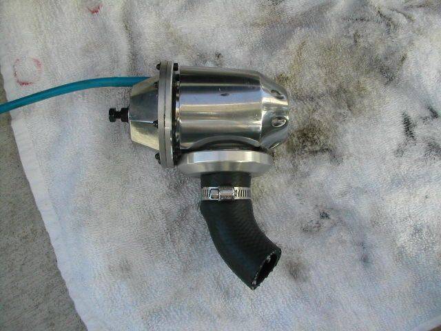

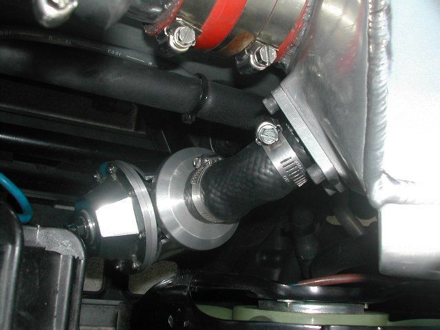

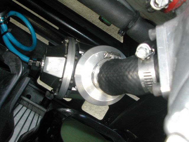

Hey that's my bov! I didn't want to weld anything, so I used some 25mm water/heater hose. That allowed me to put the HKS at a good angle.
The HKS is on a 25mm flange adapter used on VW and Audi's (available on ebay).
I fabricated something out to a paint cap, teflon tape, and electrical tape to cover the original dv inlet. I also disconnected the crank case breather hose (mated it to a catch can instead). That way, I don't have anything going into the intake pipe (i.e., possible blow by, etc).
