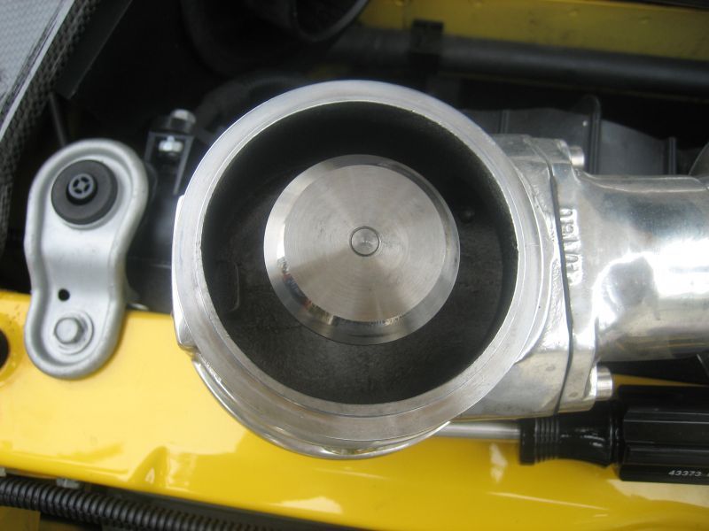

Heres a pic of my bov. From this view, the top and the bottom of the valve seems to be unevenly worn. Has anyone else expierenced this?

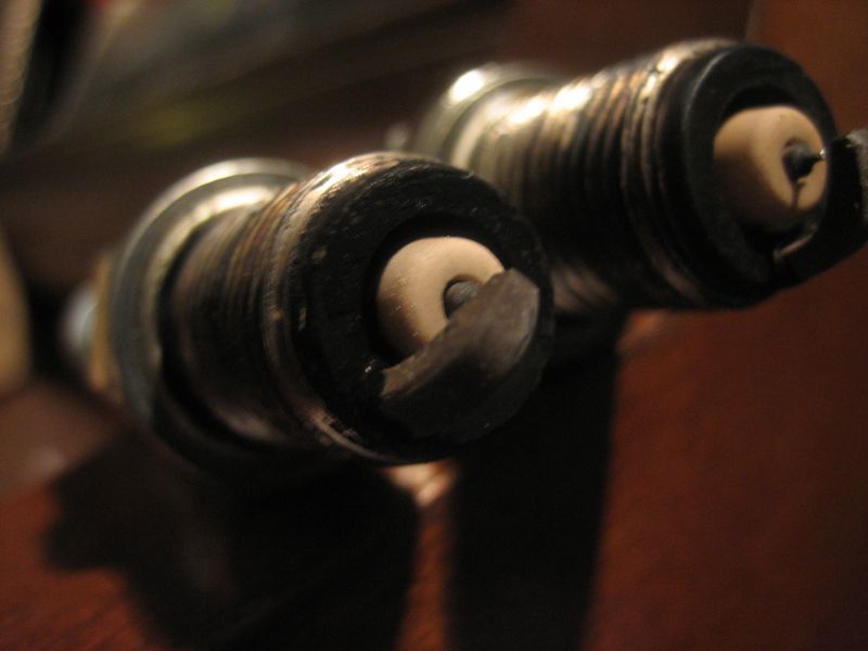

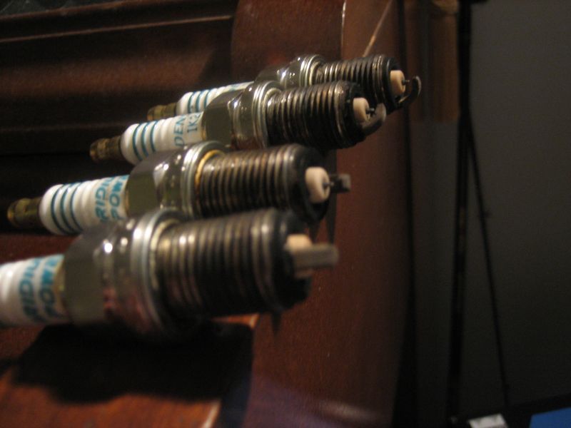

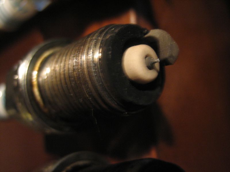

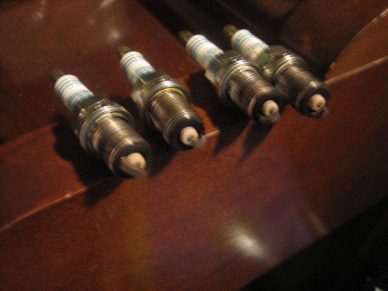

Here are my iridium plugs. How do they look? This is after about a year and a half.

Do u have a gasket on ur bov?
