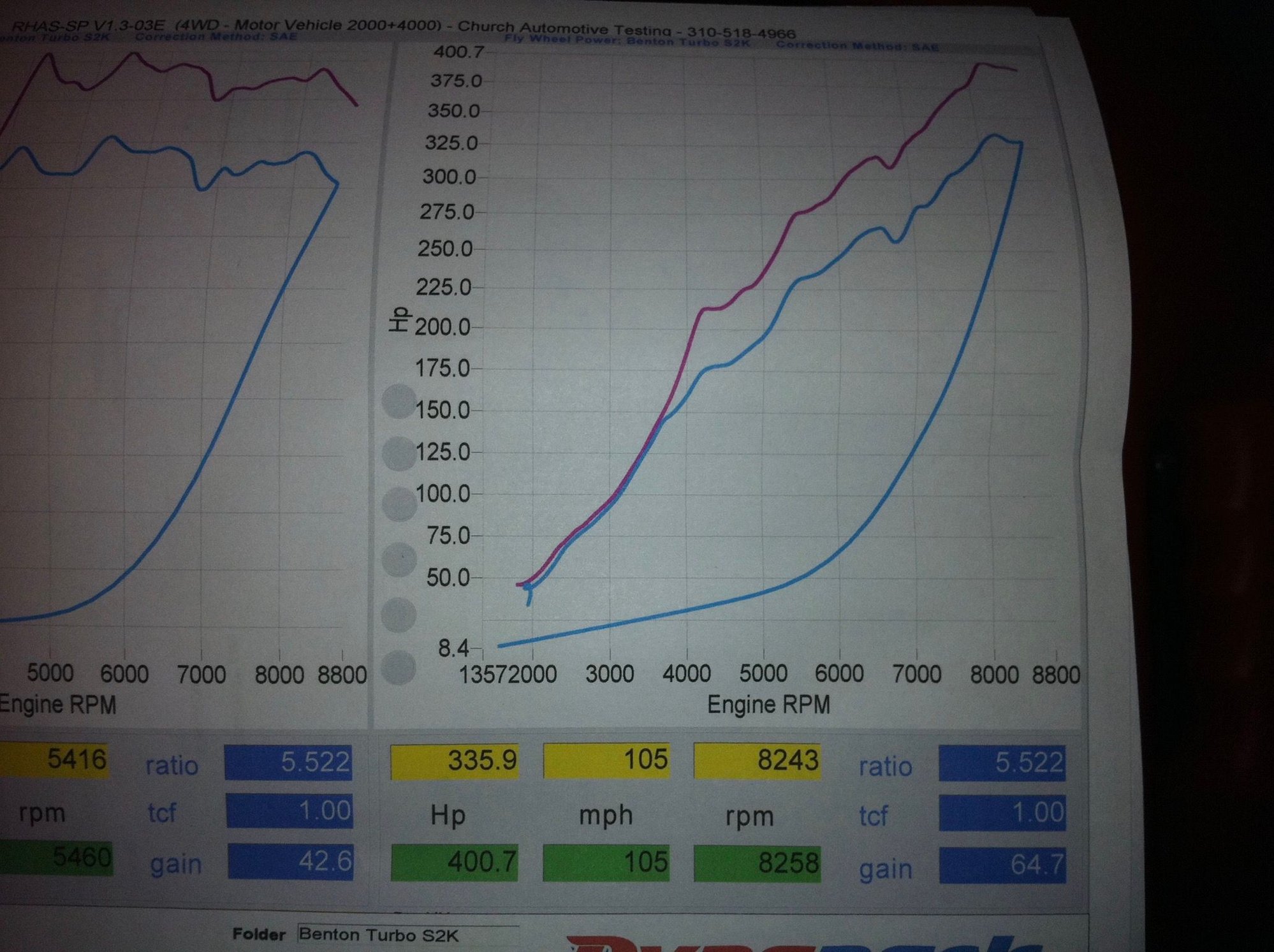

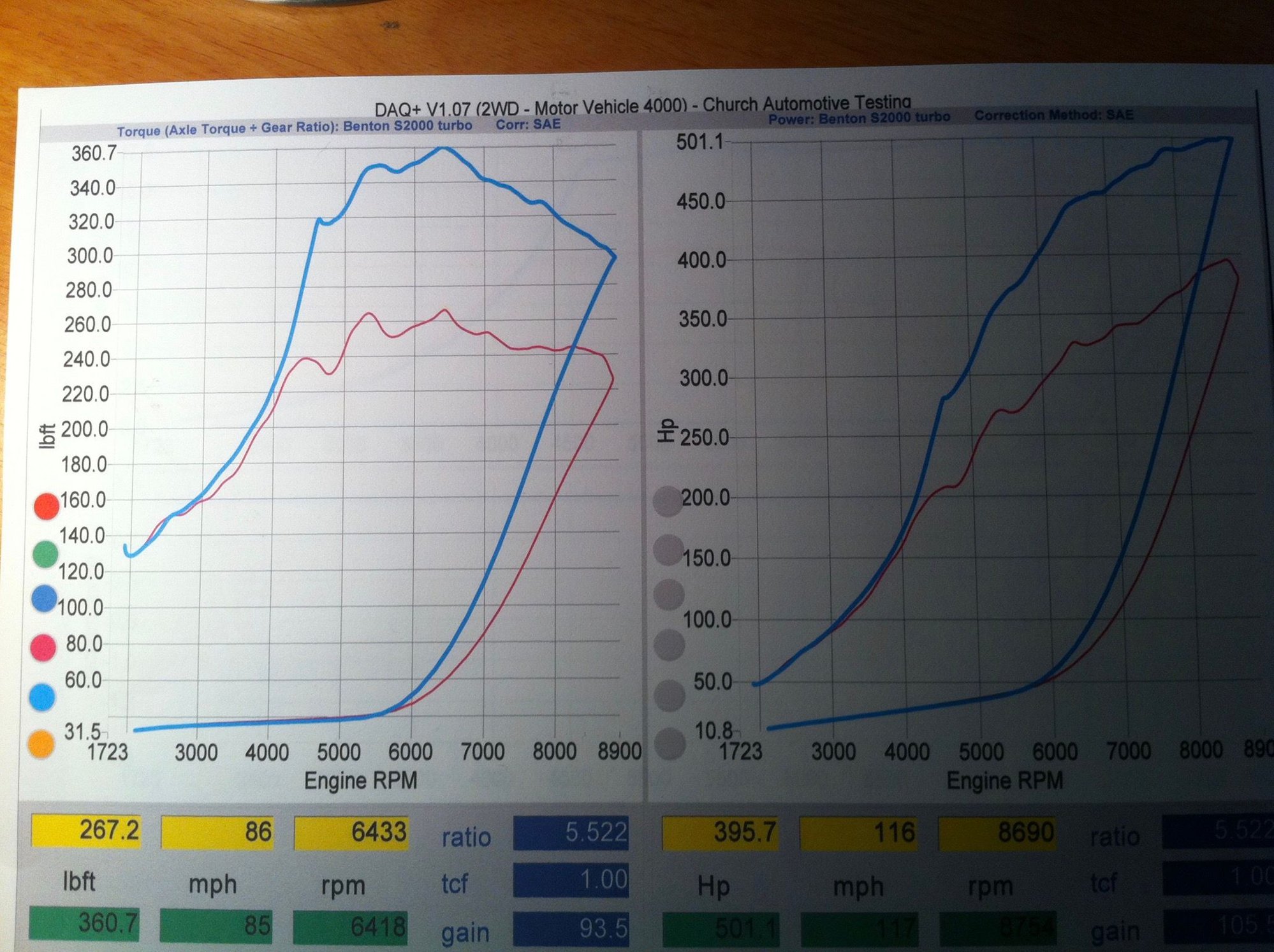

Here are 2 Dyno charts of my very own s2000 from a setup I had 10+ years ago. The only difference here in there 2 dynos is one is a log manifold and the other is a tubular manifold. Everything is the same. Same boost level same dyno, same exhaust setup.
Log manifold made 335whp on 91 octane at 12psi or boost and 400whp on E85 at 17psi of boost
tubular manifold made 395whp at 12psi on 91 octane and 501whp on e85 at 17psi
