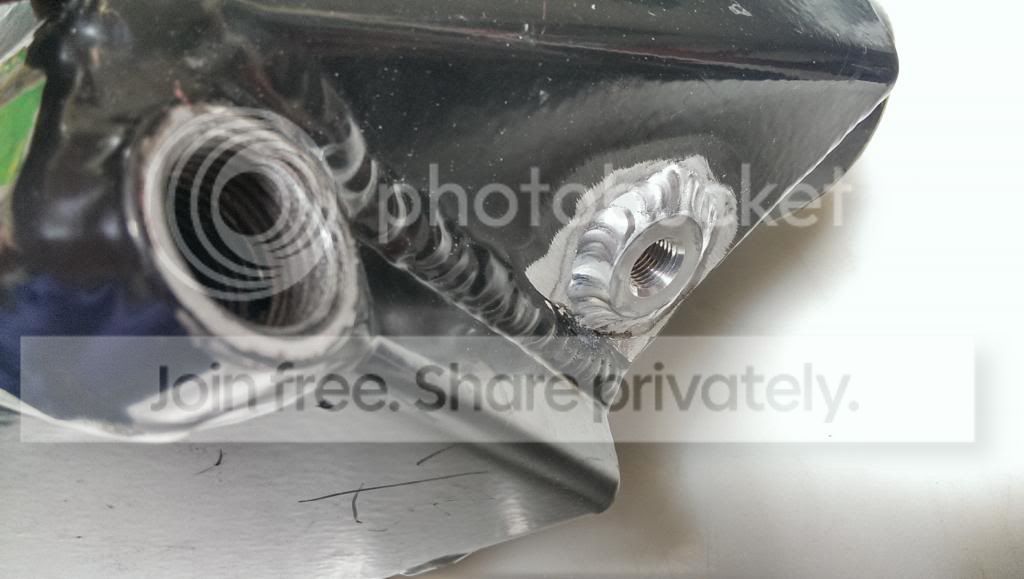

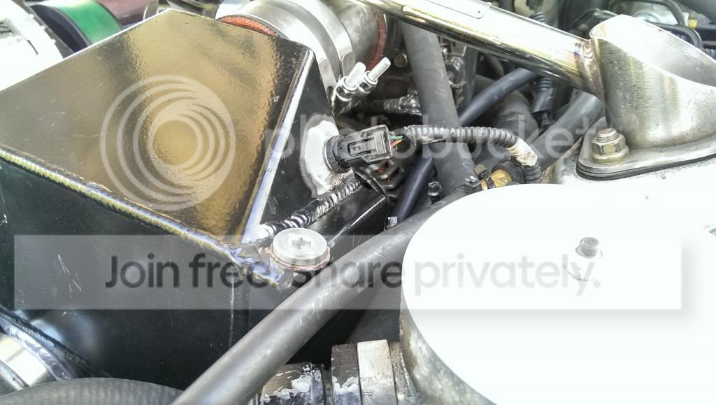

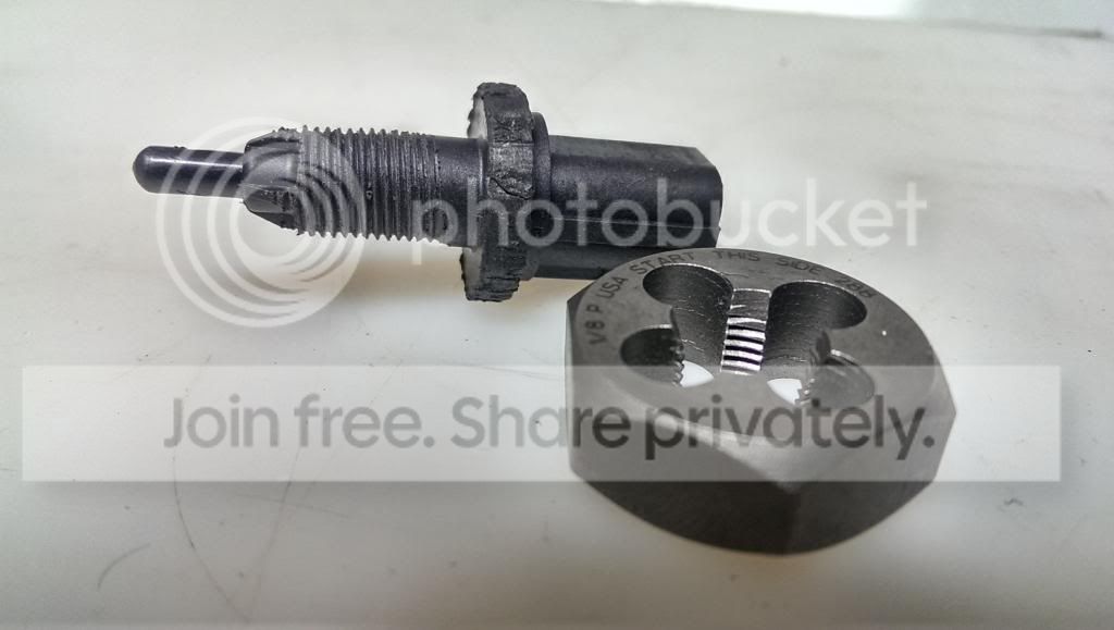

I don't understand why you'll get the CEL with the IAT in your stock location. What system do you have and where is it currently installed?
Here's my IAT relocation.
