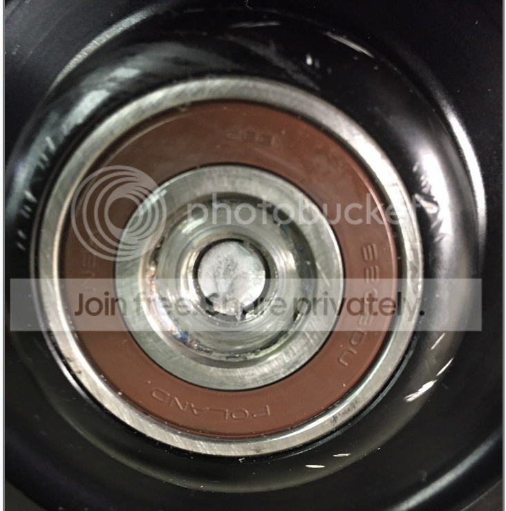

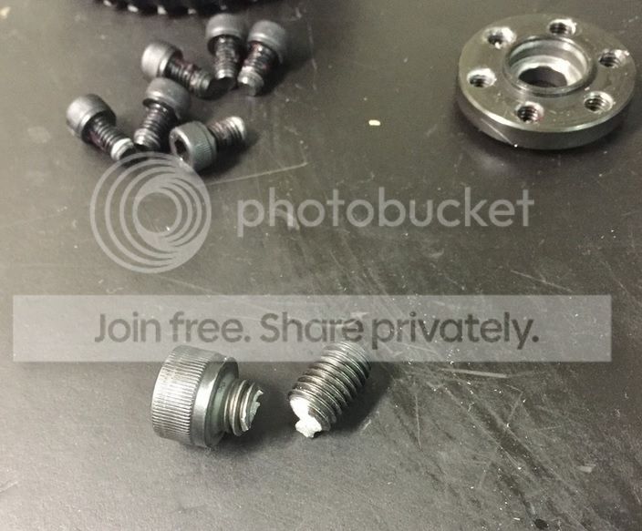

Hello all,
My friend and I are in the middle of installing the new KW C38-91 blower kit onto his S2000. I have seen a lot of threads about the blower pulley adapter bolt snapping in half. I was wondering what the resolution is to this issue. Are people settling for a warranty repair through KW/Rotrex? Are people upgrading these bolts?
As far as the kit goes, I plan to do a thread about it, but for now Id like to focus on this bolt and how to address the issue.
This is the bolt I am referring to:
(Pictures from "The Machine")

maybe try a stronger grade bolt?
my vortech bolt is a gold color stronger typ of bolt.
if a top lv bolt don't hold, than i guess reicard @tts is right, the cob belt system will fail on rotrex units.

It would be great if someone could get a good pic of the head of the bolt, one of you that has a kit you haven't installed yet... we should be able to determine what grade it is.

We plan to upgrade the bolt. We are going to figure out the size and grade, then look into the ARP bolts. They offer a wide variety of bolts

Looks like a socket head cap screw with a class 8.8 wonder if they would upgrade to a 12.9

hi rain H&R i Brake 3 bolts in 5 month... now i have the car in the shop we are working on a cnc port head , custom intake manifold and cams.... and also we are building a new custom Billet forged bolt .. i will upload pics in a few days of the bolt and the other parts in my topic. since this bolts brake when you hit the rev limiter a lot and oversping the blower... i look for the arp bolts but they dont have the head alem that use the pulley from KW.
omfg.
he or anyone els never mentioned any of these.
3 bolt in 5 months.
now i started to get nervous, i just placed the order for 91 blower n i5mm pulley.

I am just referring to the picture above, I am still on the fence for the kit at the moment and don't want to pull the trigger because of this. One of the main concerns is that if you open the blower and replace the bolt yourself you pretty much void the warranty and only way to get this repaired is sending the blower back to Rotex which will just cause more downtime for the car.

You don't have to open up the blower to replace this bolt, at least I can't see any reason to need to do so. I think Nik is the only one with multiple broken bolts. Anyone else that experienced this only had it happen once, that I've seen.
I have several thousand miles on my kit and I've hit the the rev limiter several times. No broken bolts here.
I think hitting the limiter a bunch, and having an aggressive limiter are big factors in this. My limiter is fairly soft (Aem v2, Evans tuned). I rarely hit it, as a rule, even before I was boosted.
