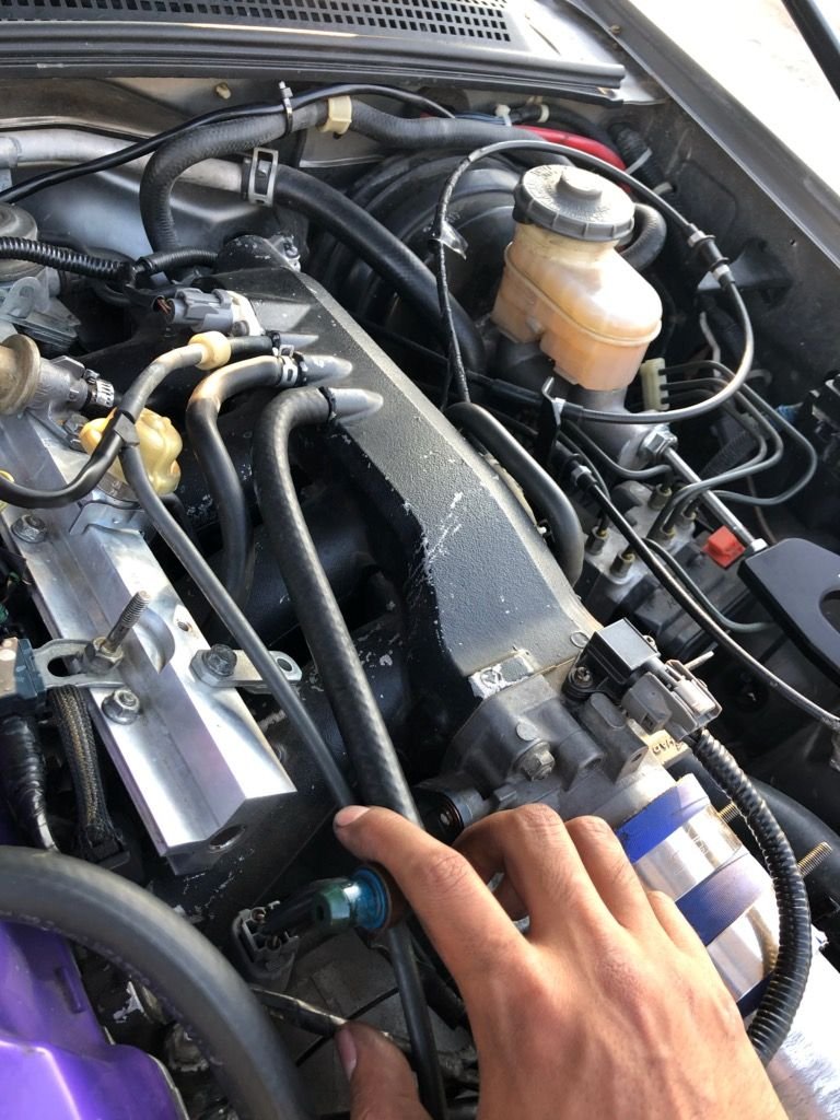

I was wondering if some of the work that was done by the person that installed the supercharger is wrong or sub-optimal. I have a feeling some of it is supposed to be different, and right now my first though is the BOV plumbing. Can anyone with experience verify and please advise on how to correctly plumb this? Pictures attached.
More details if needed: tube to far left goes to FPR and the BOV. Middle tube goes down into a different line that I think ends up at the intake manifold under the throttle body? And right-most tube goes to air intake.

The hose coming off the fpr looks like its collapsed. That's not good and would cause some erratic idle behavior id think. That line really shouldn't be Y there but run off a dedicated vac port. There should be another one in the back of the manifold that went to the air injection system. T off that instead for the BOV.

Its pretty standard size vac line which you can purchase in bulk at any auto zone/napa etc - its one size up from the smallest vac line produced. Just take a section of it in to the store with you to size it up properly, then buy 3' or 4' of it and cut to the size you need at home. Its cheap. The port im talking about is the last one on manifold closest to the firewall - you can see its a very short run maybe 3" to that air/check valve bolted ot the manifold. Its the round looking thing. Take the Y fitting from the collapsed line and use that to split off that back vac port with the short line thats there already and run the new line from there t your BOV, then replace the collapsed line with length you need. Im not saying this is for sure going to solve your problem, but from a guy looking at your engine bay from behind the computer, this is clearly not right and could be contributing and should do it anyway.
The other thing you might have an issue with is voltage to the fuel pump - if your running a bigger after market pump, they can drain voltage with the stock wiring and when you turn the steering wheel or ask for any other voltage demands from car you could be robbing fuel pressure. That collapse line to fpr may also be causing the fuel pump to work overtime. or simply causing pressure to be off what the EMS was tuned to and is fluctuating.
*Also please re orientate the coupler to your throttle body, it looks like its about to slip off the end. You can see it looks very haphazardly placed on there. And whats the threaded port hole we see on the BOV which looks like something is supposed to be there? m not familiar enough the the Vortech BOV to know, but id be suspected boost loss there if there is supposed to be some kind of plug or fitting.

Might be the angle, but also check your throttle body. Looks like the charge tube not on fully on the last pic. Kinda looks like at and angle and clamp is right on the edge.

@s2000Junky Took all of your suggestions, car idles without a hitch now! It used to have little hiccups before, have not tested the steering wheel aspect of it yet but will update tomorrow when I take it for an actual drive. Definitely a much smoother feel all around. Adjusted the clamp on the throttle body, I hadn't caught that to be honest, but was a good change all around.
