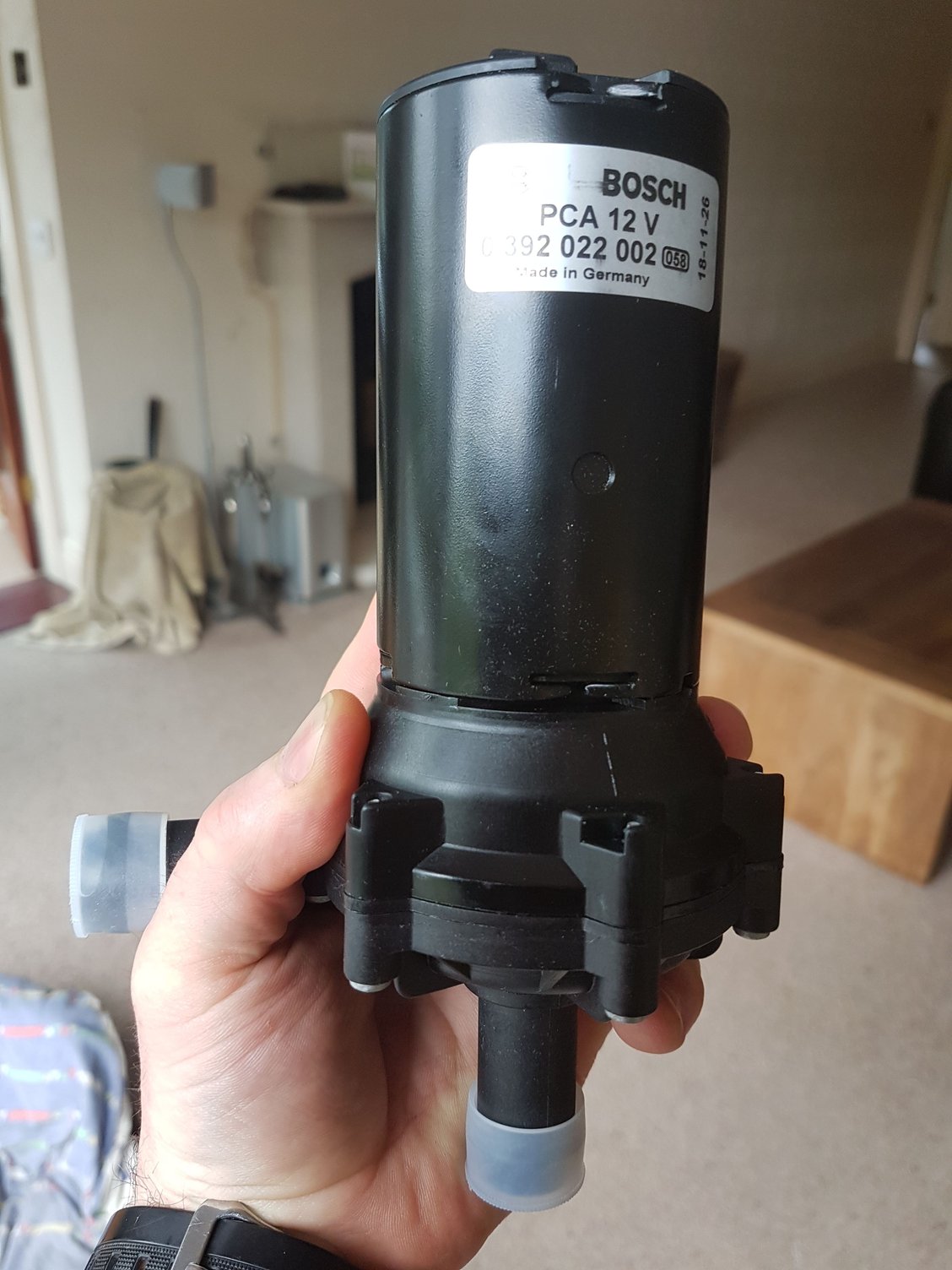

I fitted one of these Bosch pumps.
Yup, that's the one.
This pump looks HEWG. How has your experience been with this pump? How has it been in terms of keeping your aftercooler temps consistent etc?
Plasmaman uses a smaller BOSCH pump ( https://www.ebay.com/itm/15307946226...3Avlp_homepage ) for their water to air cooler setups that might look more thrifty on space. I am wondering because I have a SOS kit I will be installing soon and it definitely has the Johnson (newer style) pump included...

Pump has been on for 5 years & yes, it's bigger than the original one that came with my kit 12 years ago, but it definitely does the job. Here is the description from their website:
OEM Upgrade Intercooler / Chargecooler Pump, superior power and flow output compared to the original Bosch Pump
Our industry standard 1200L per hour capacity, and more stable head pressure than the original Bosch pump. Will improve performance in all OEM applications. Exact drop in fitment, no modifications required what so ever.
