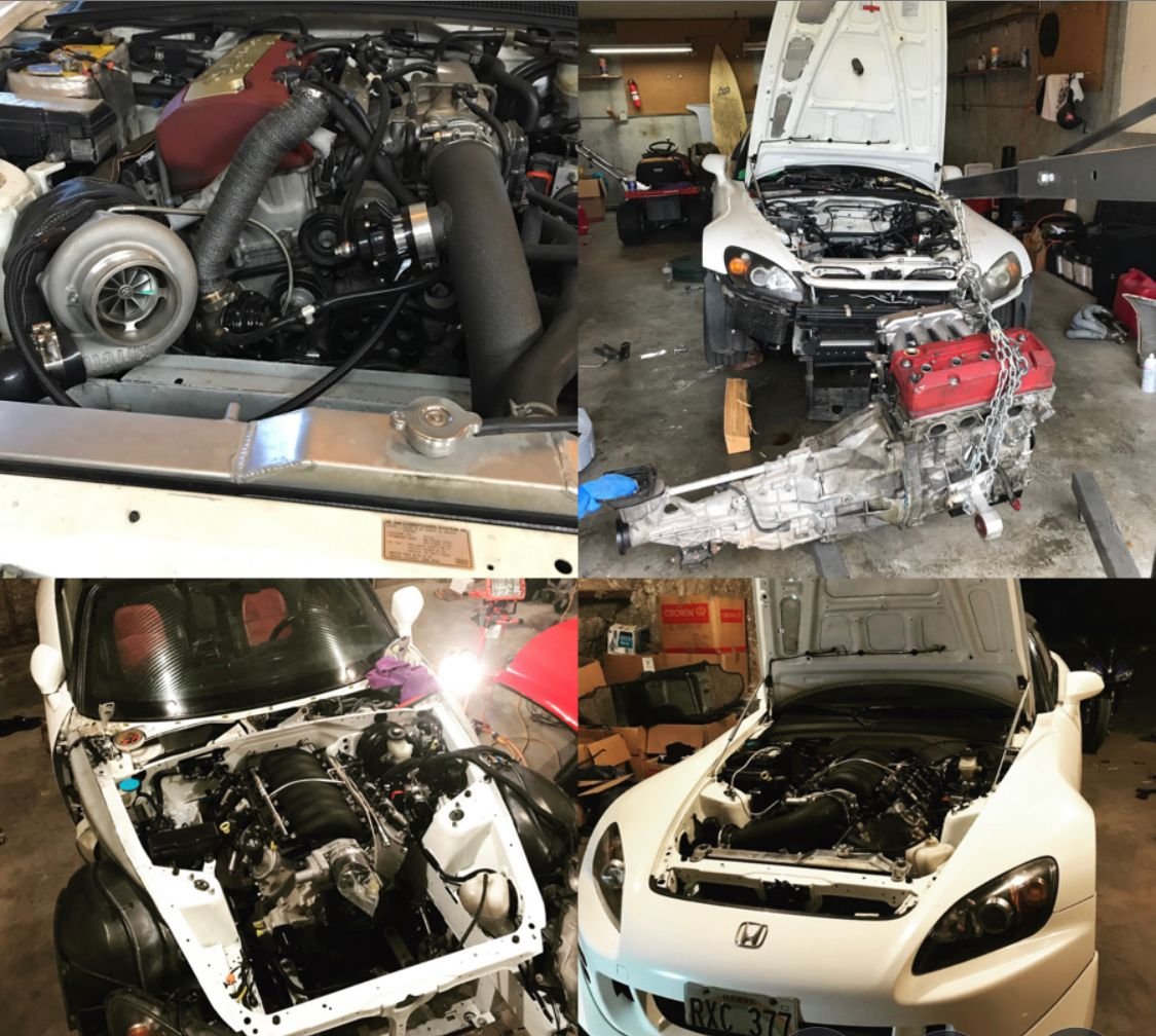

I ran an SOS TS Max 3582 non billet (first turbo system). Made 420s with 300wtq 12ish lbs. Honestly the extra dough for billet isnt warranted in my opinion. It spools stupid quick as is; I think the difference might be Around 200 rpms sooner.
After going fbm v2 from the sos mid 2017, I quickly realized how fun to daily and drive regularly the sos ts max was. The long end of a 1/4 you would get reeled in by another system, but it would suprise a lot of builds, domestics etc.
I actually loved the down low torque so much (sos) I ended up going 6.2 liter crate. Its fun to drop in though and happen to see a post about where it all started.
