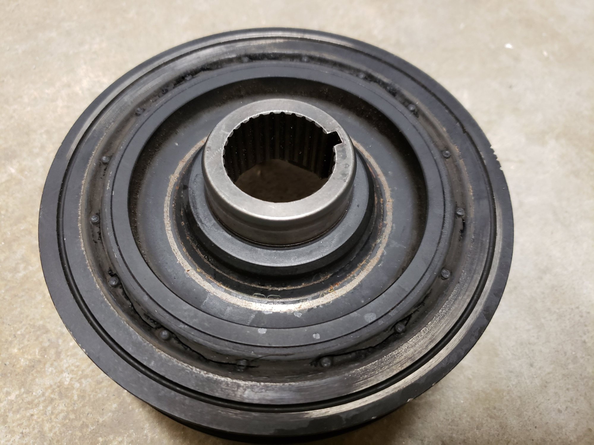

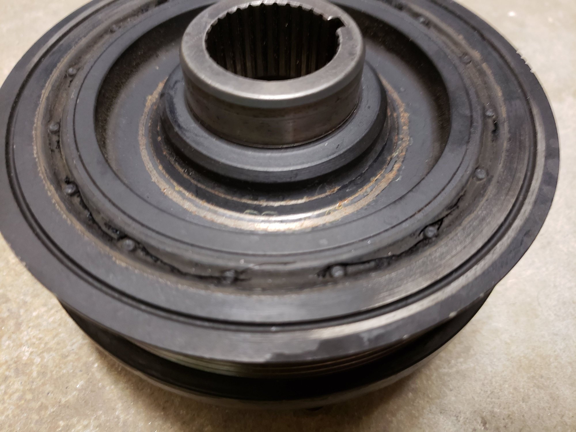

Reporting back for the next person who encounters this problem. Ended up being crank pulley failure. When I first checked this it seemed solid. Only after taking everything off, I could wobble this with my hand.
Car was driveable at low rpms. Under load the pulley would deflect and throw the belt.

Wow cant say ive seen that kind of crank pulley damage before.
Glad you found the problem.

Never seen it that bad either. Wonder what caused it...

Salt, sun, miles and lots of torque

Salt yeah I can believe that. Maybe play on the pulley unknown to the owner wrecked it over time too
By the way, am I seeing this correctly - you literally bolt the VT pulley on top of the stock one via allen keys/screws??
