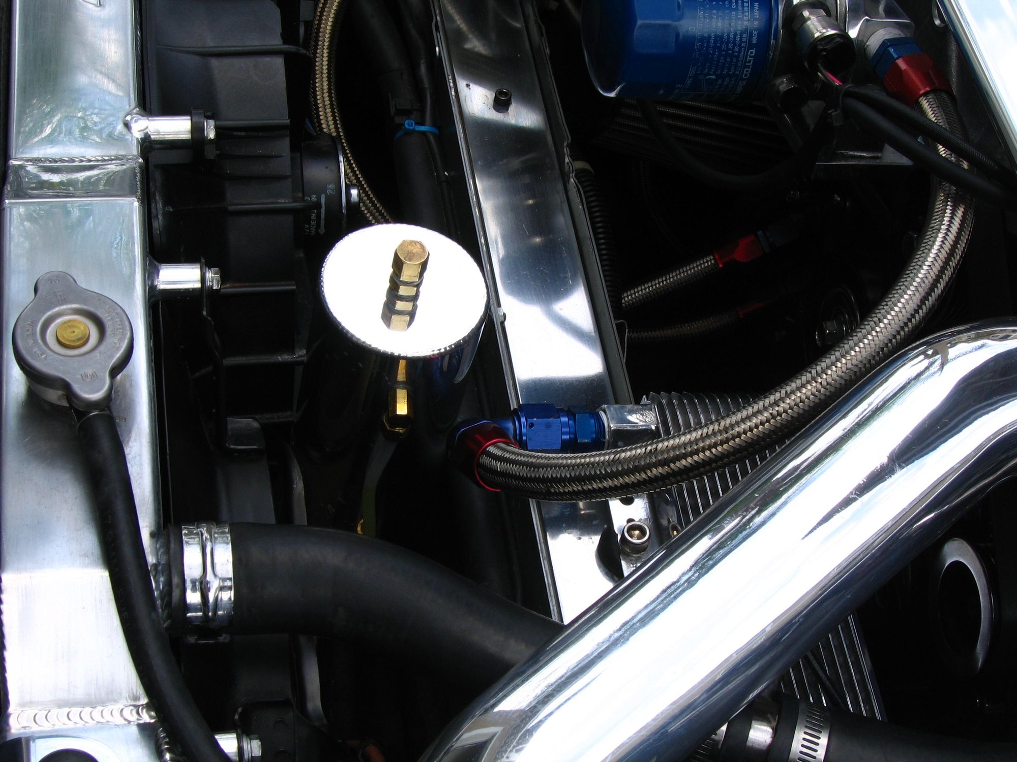

Here's another option for the coolant overflow tank. I replaced mine w/ an overflow can i picked up from Summit Racing. Added a sighting tube and made a mounting bracket out of aluminum. It works fine and adds a little bling too

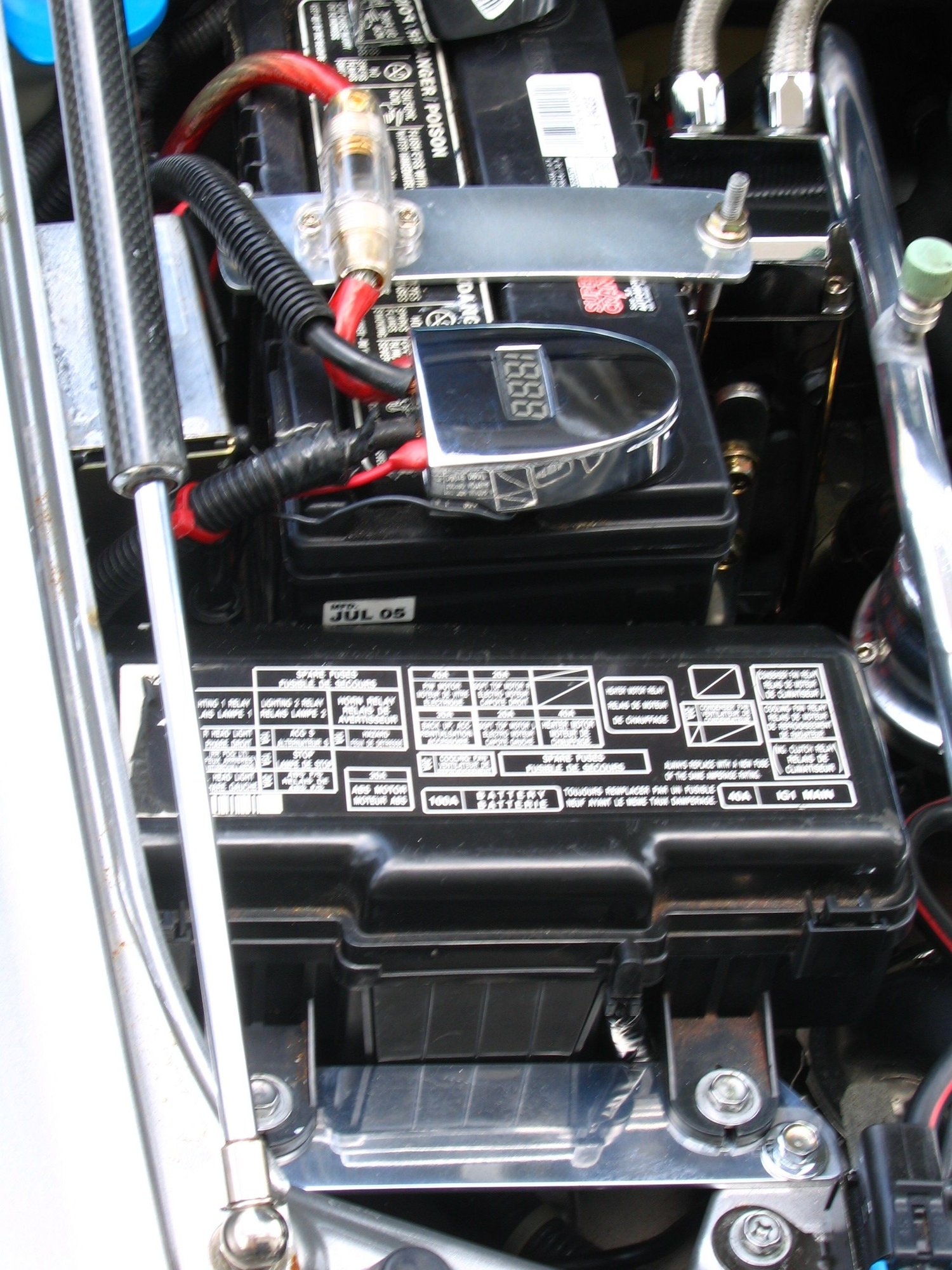

Also, here's the aluminum bracket i fabricated to move the fuse box a little closer to the fender. As you can see it's pretty simple. You can get aluminum stock like that at home depot. It's usefull for all sorts of little things like that.
