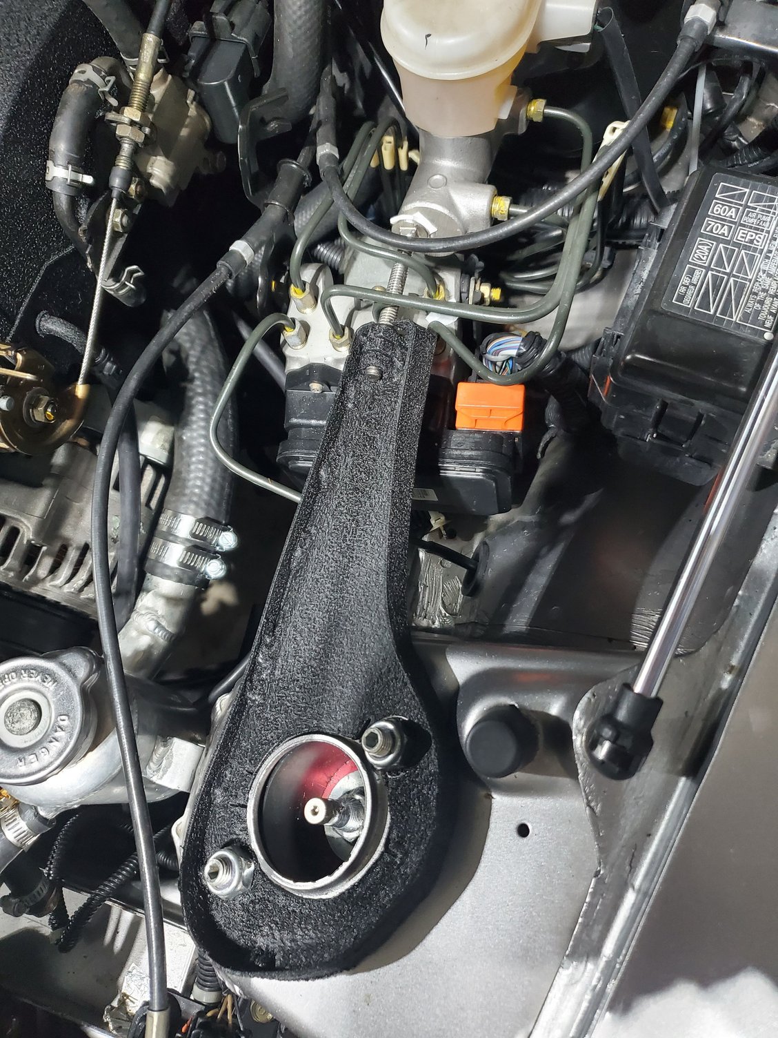

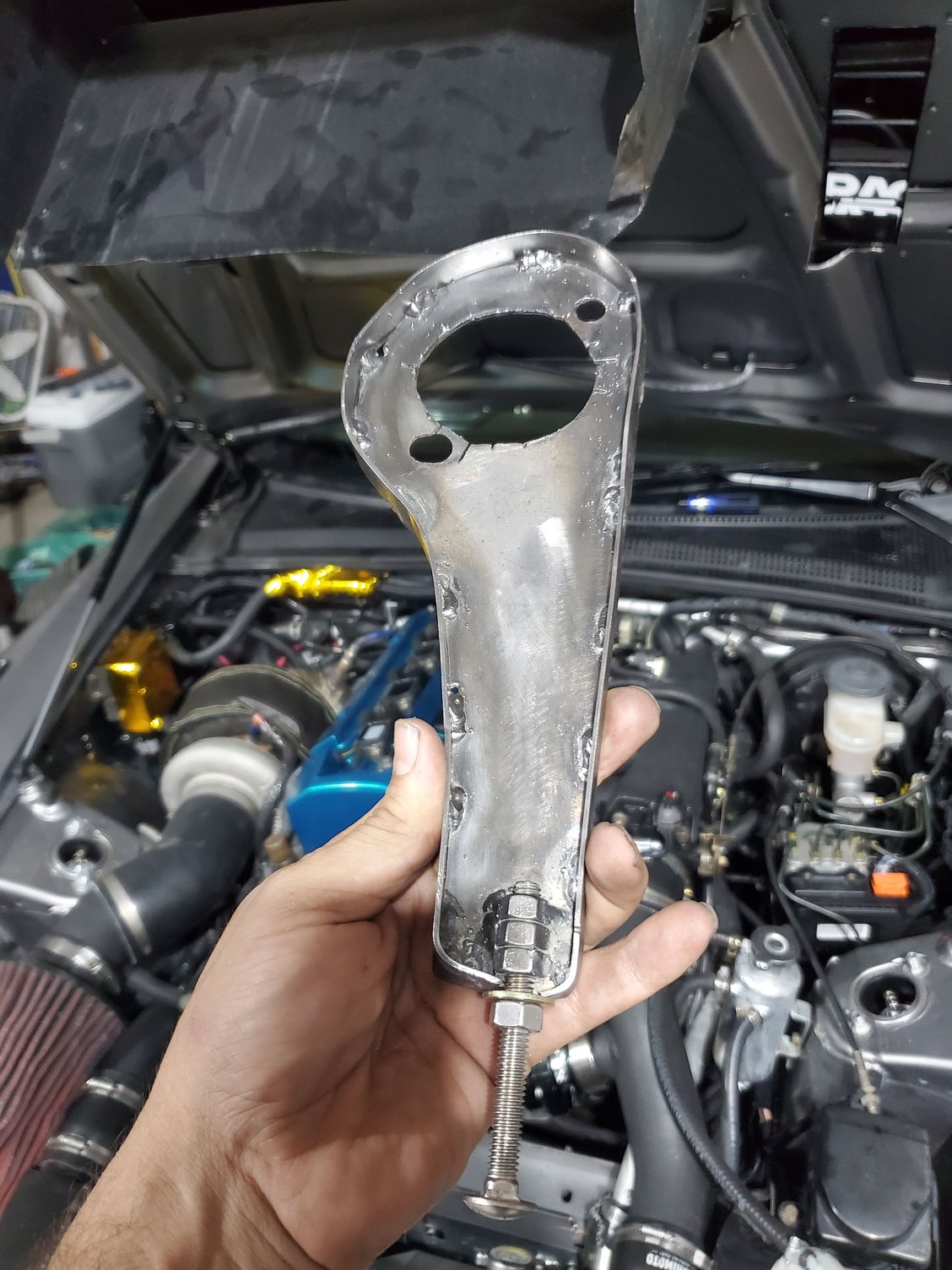

also whipped up a brake mast brace with some scraps i had laying around, came out decent.

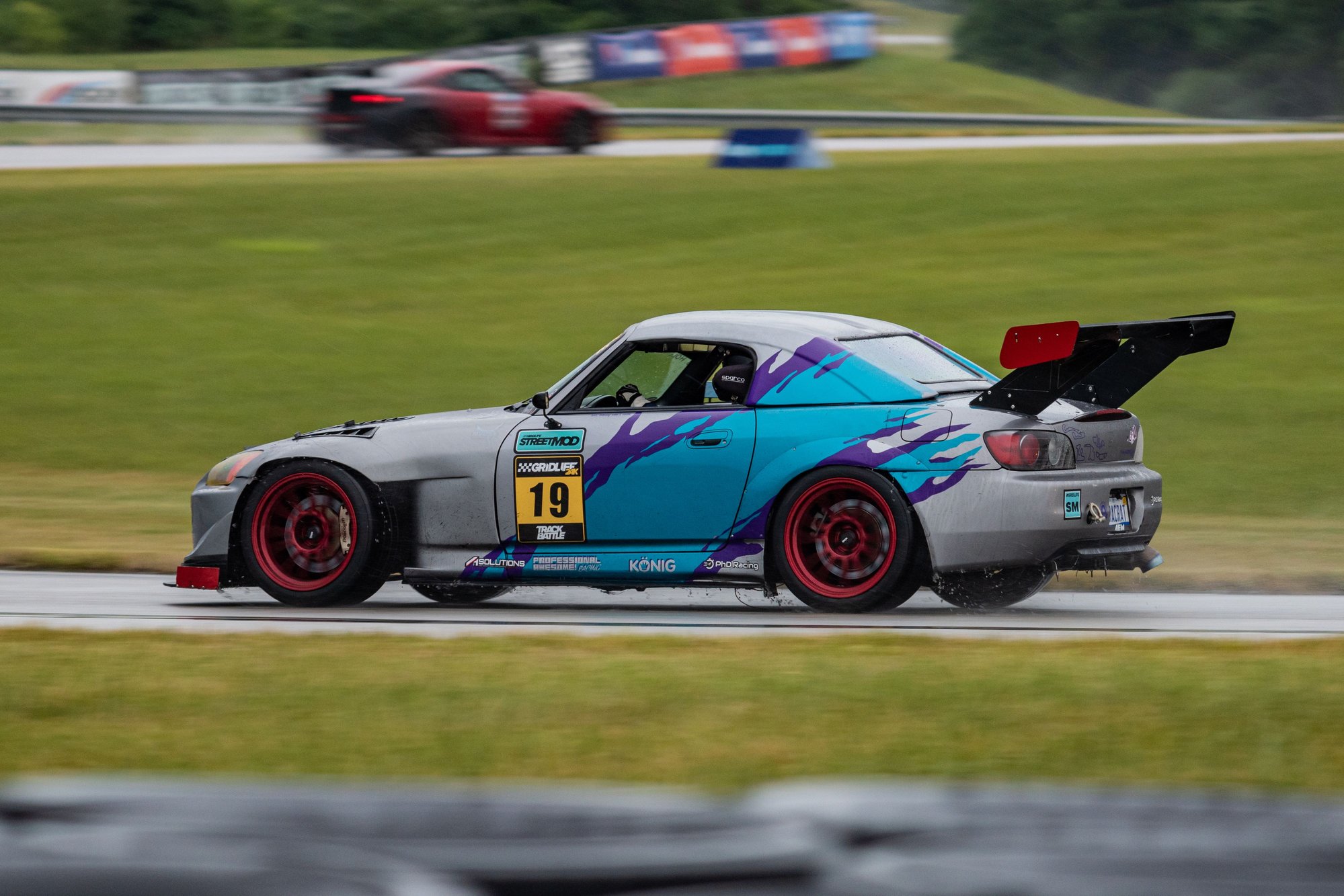

and here is just a few shots i liked from midwest fest. the thursday night sessions were pretty great photo ops

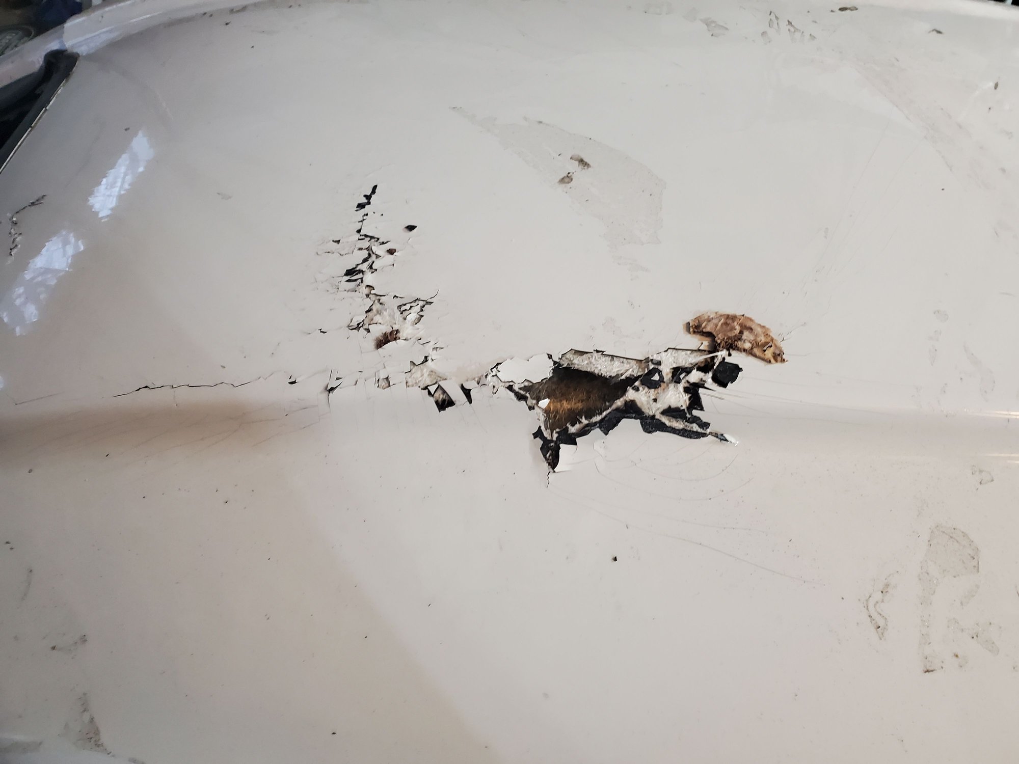

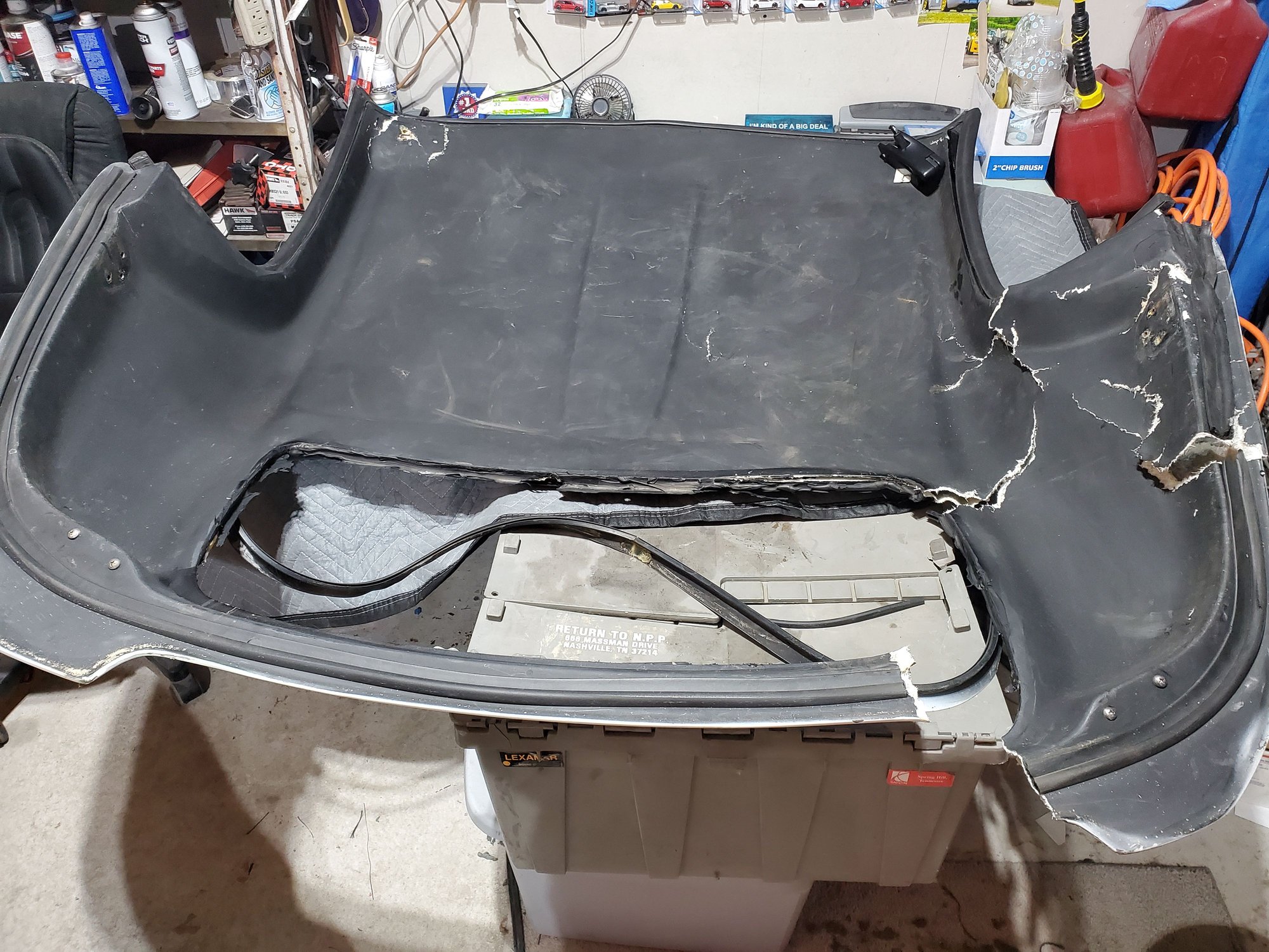

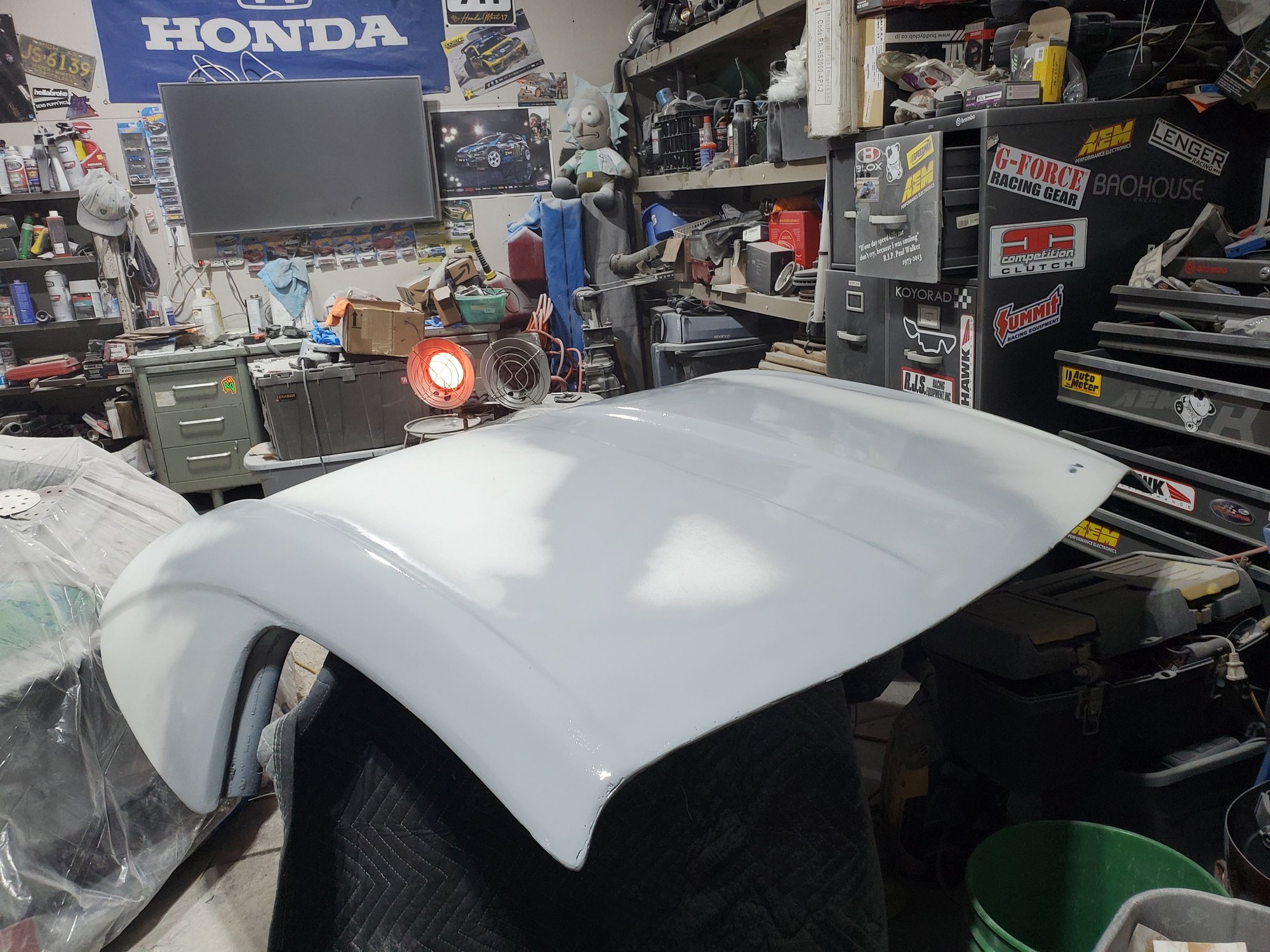

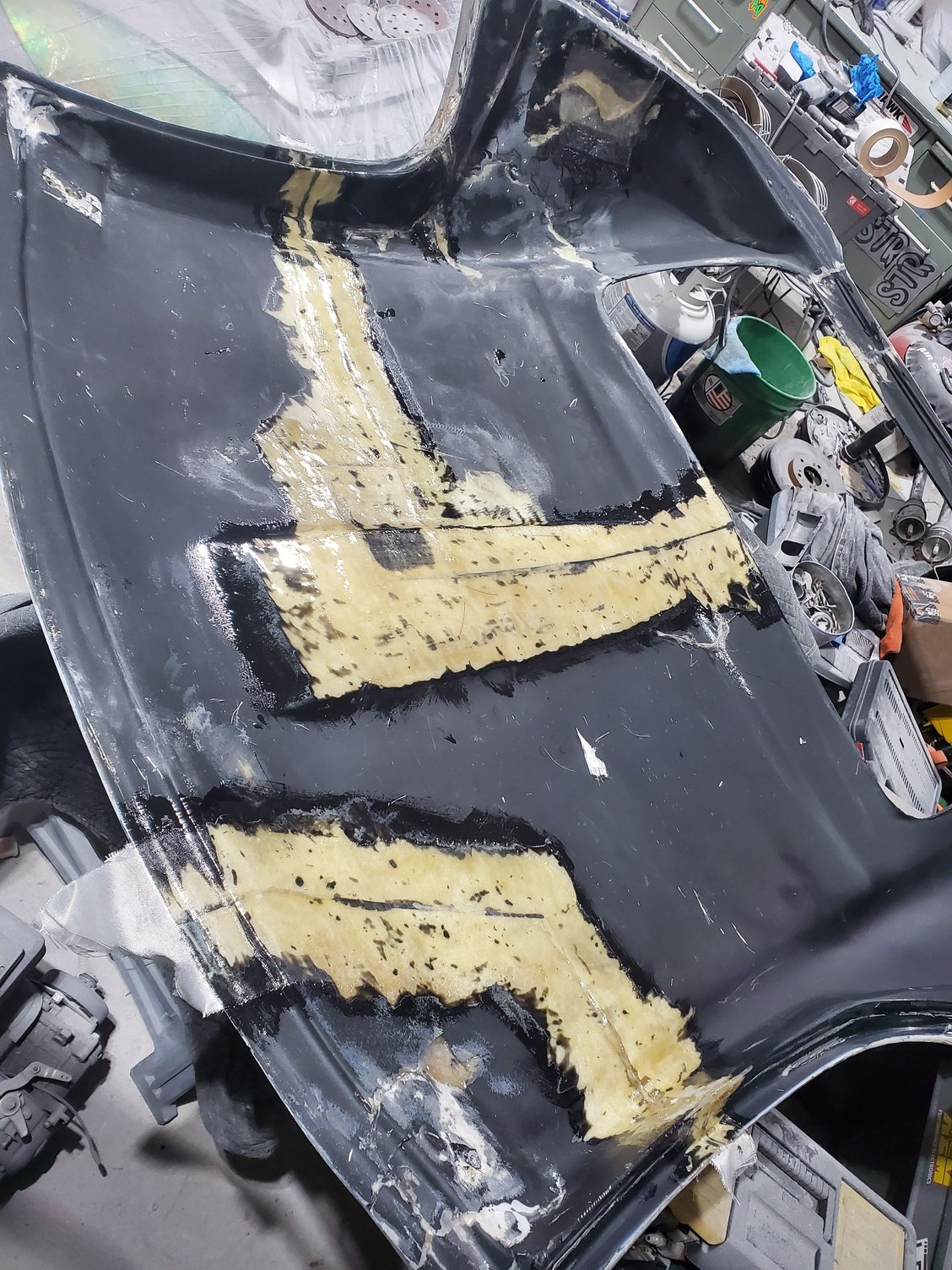

winter plans went well as the list was short. i did add to my list by acquiring a totaled hardtop from my guys over at a-solutions. but for anyone following along a little bit of work never scared me away.

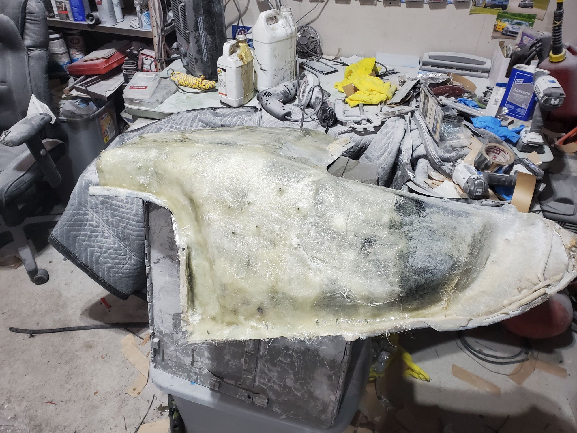

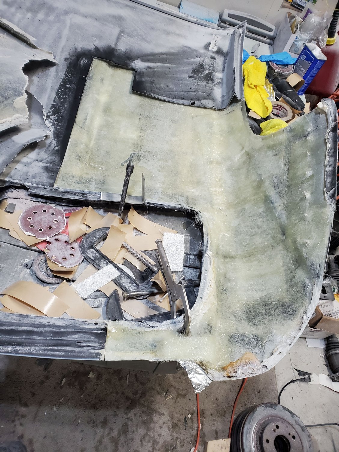

so i got to work, first step was cutting the hardtops inner and outer shell apart to fix the damage from the backside. this allows me to grind out all the cracks and damaged fiberglass and then layup arguably too much fiberglass to repair it. i figured better safe than sorry id rather have a top a couple pounds too heavy that will never fail than try t be a weight weenie and have issues later on.

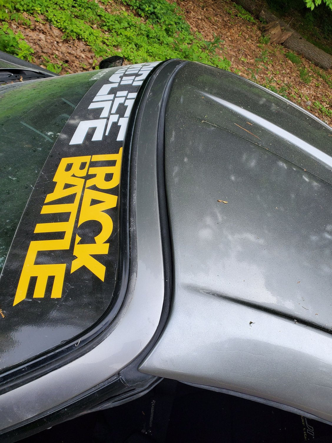

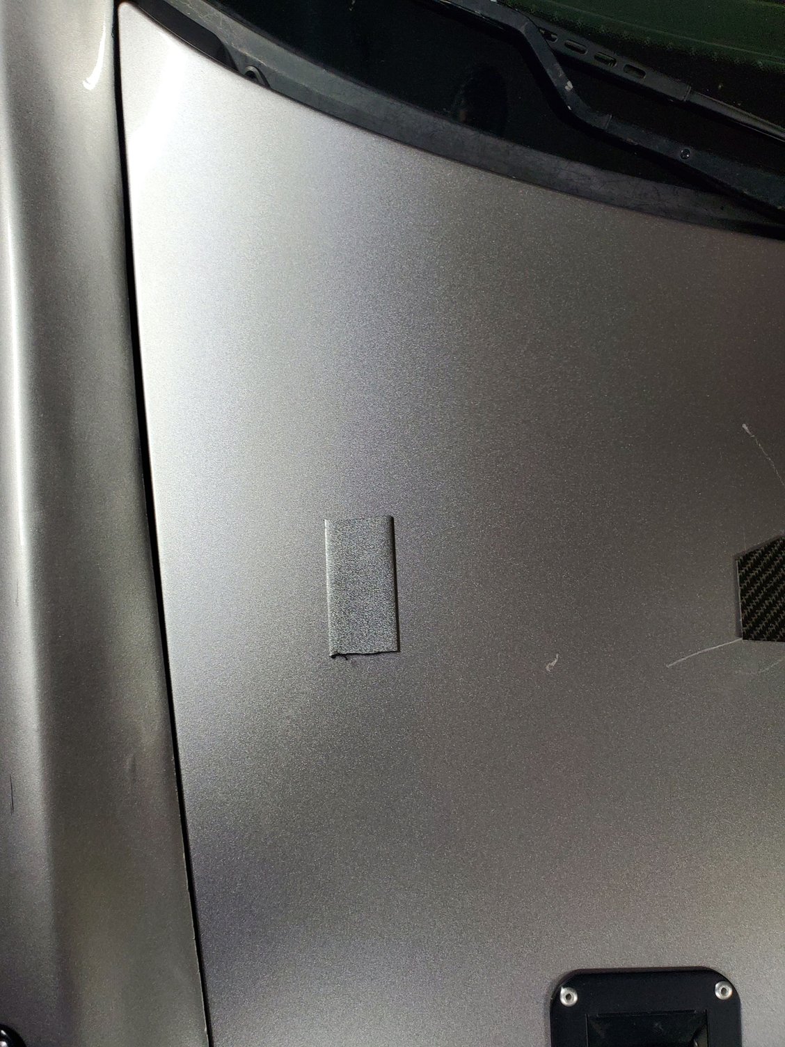

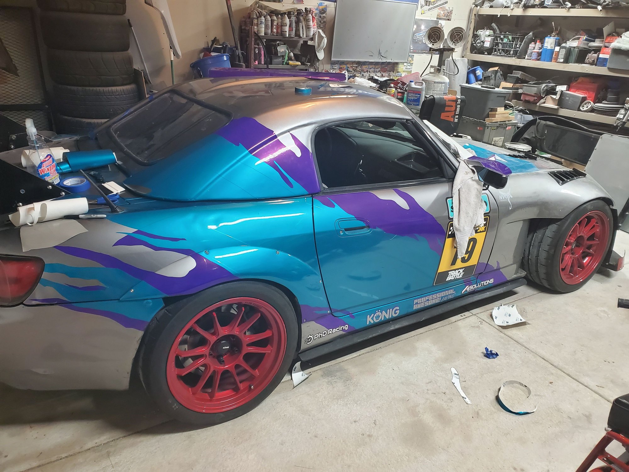

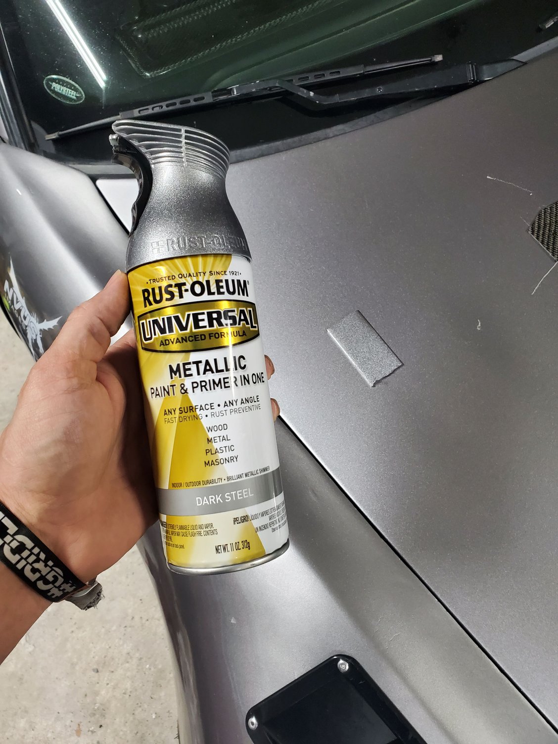

i have literally hundreds of pictures of this process, this was no small feat and took probably close to 50+ hours of work....sooo much sanding and blocking. i used panel bond to bond the inner and outer back together. now this part happened later i will put it here just for continuity sake to finish off the hardtop saga. walking through home depot i spotted this out the corner of my eye, so i grabbed it figuring there is no way. test panel said more than close enough for a racecar, do i recommend on your street car ... no, for a race car plenty good enough. wasnt sure if i wanted to flow the llivery but super glad i did i think it looks great. oh and i just blasted it with the same brand rattle can clear coat as well.

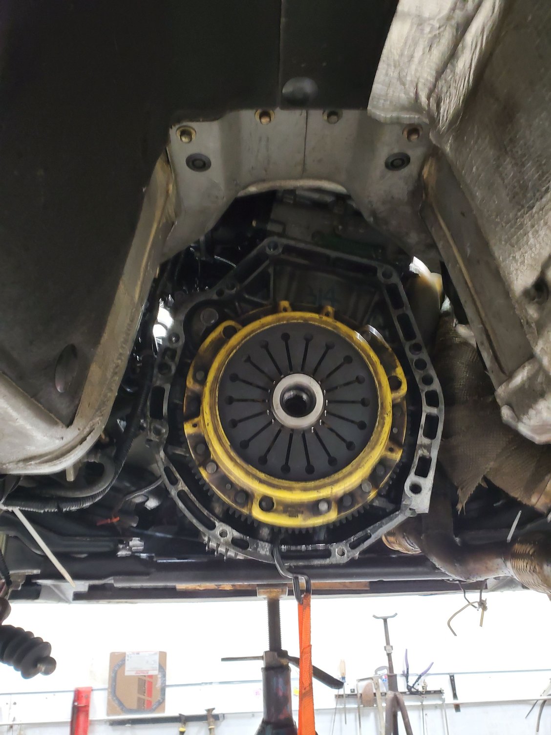

next up was the glooming issue from last season and that was my clutch, first time not doing this on my back and boy what a treat. just tossed a act 6 puck sprung disk in with the current act hd pressure plate. um...i hate it, but its holding all the jams so i'll survive. its cheap and the biggest reason is im still undecided about a transmission, i didnt want to drop a couple grand on a twin disc only to move to a beefier trans option and render such a pricey piece useless.

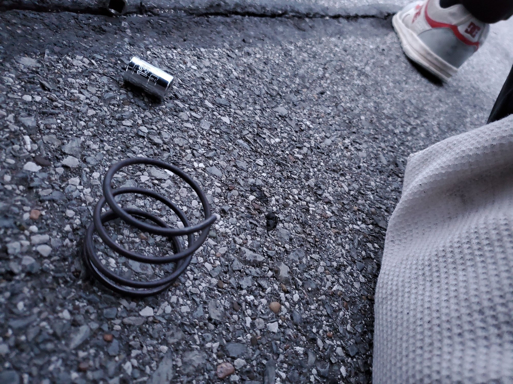

now that the offseason is caught up stop one... NCM, now i have never been here and to say i was nervous was an understatement, this place is massive. im used to 2-2.3 mile tracks with a dozen turns or so, easily manageable to wrap your head around. its 3.2 miles with 23 turns, lots of elevation and blind corners. its one of those places that really reward sending it but critical you know where exactly you are on track. and then boom i run into issues, whats new. day one it was wet for the first session, cool, im fine with slower pace to get my bearings, second session im hitting boost cut...f#@$ me not again i thought this was fixed. im like ok, im still learning the place just do what you can do and get some seat time at this point. pulling the gates off would mean missing my sessions and i opted to just say get the seat time for day one and work around the boost cut the best you can and lets fix this after the track goes cold. also pretty excited in the nearly a decade ive been racing on tracks this is the first time my wife and kids are coming out to spectate with my sister-in law and their family. so i do my thing trying to move up in the run groups but being handicapped pretty bad i get through the day. upon pulling the gate apart worst case scenario, i assumed it was just the valve sticking again...nope, ripped diaphragm. there isnt really a way to fix this, not track side anyway. so me and my buddy (also a scott driving a s2k lol) come up with a mcguiver solution. i remove the 10 psi spring only leaving the 4 psi spring, we then cut that spring down, lets let the back pressure just push it open. the second gate is still functioning so i just need barely any pressure to keep it shut and in the upper rpms in theory the backpressure should push the gate open a bit. this silly stunt actually worked, held 18 psi just fine! but it also caused me to lose an axle. swap it out and well now it comes down to the last session of the weekend and truthfully, just got hung up in tons of traffic, because of the boost issue im not stuck back in a pack of much lower hp cars and every strait i get to is either sketchy passes or i just had to wait for the opportunity to pass. i didnt know the track well enough so i opted to be a bit conservative on passing and ultimately ended with me not going very fast. id love to go back and give it a proper rip.
when i got home i promptly made and order, im done with shitty gate issue, i should be set now... thank god they were close enough in size everything still bolted up, i was pretty concerned about that. twin scroll is great for response until you realize you have to buy two wastegates, which is why i cheaped out in the first place. lesson learned
