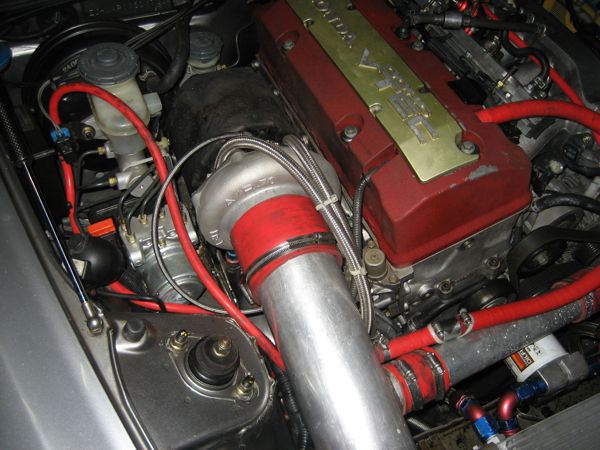

I used AN female couplers and bulkhead fittings to make "extension" fittings so that the coolant and oil hoses are located farther away from the turbine center section. I like how they turned out and it was relatively cheap. female couplers are about $7 and bulkhead fittings cost $6 for straight and $11 for 45*.
Luckily, the 45* -8AN bulkhead fitting for the coolant line fit just right thru the gap between turbo and engine mount
