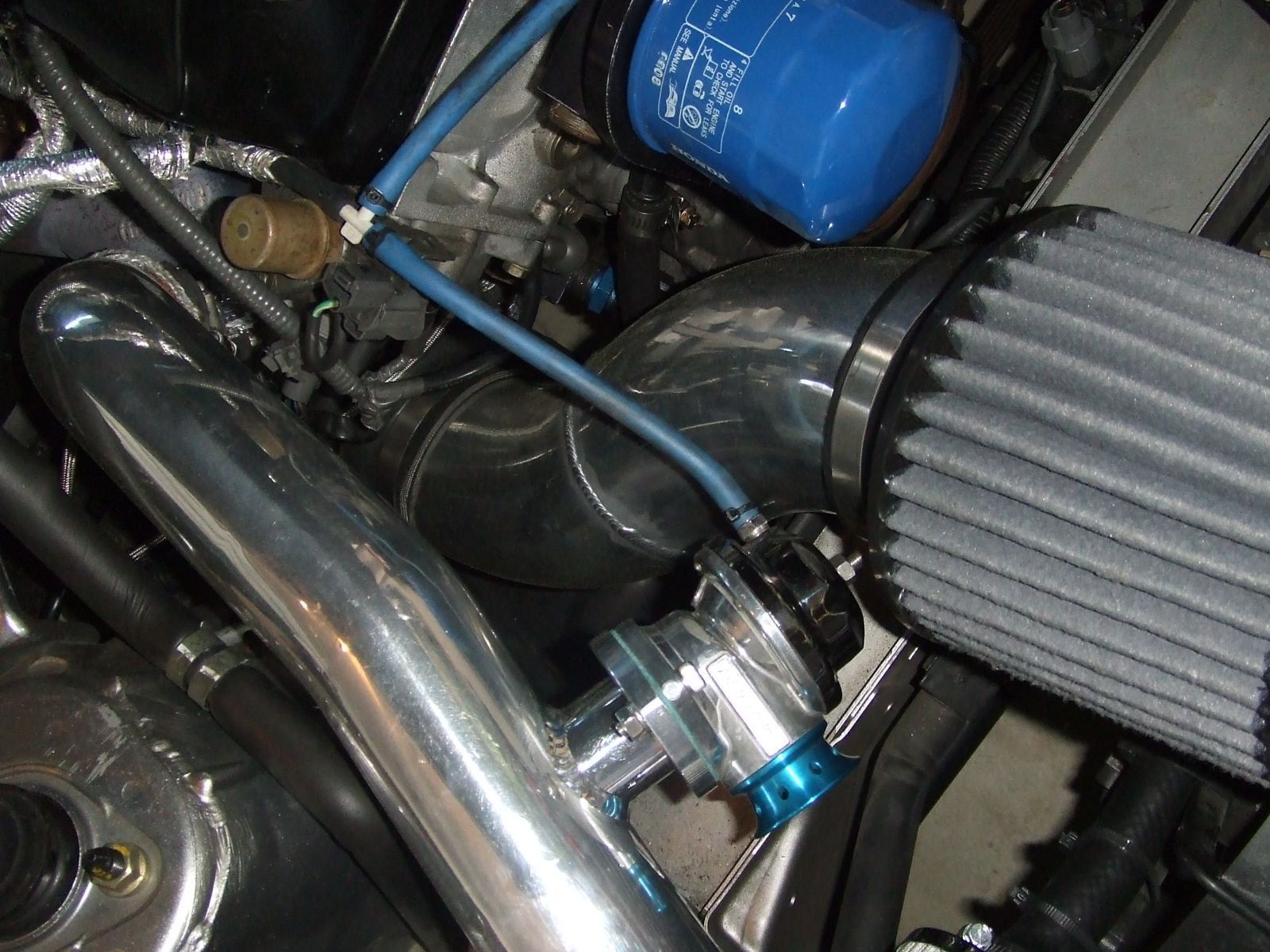

Revenge's Avatar
Joined: Oct 2007
Posts: 2,259
From: Annapolis MD
Old Apr 24, 2010 | 05:07 PM
freshs2k's Avatar
Joined: Aug 2005
Posts: 1,664
From: No va
I run mine like revenge's ^ just a little more to the left. I ran with a screen and a filter on the dyno I didn't see any differences. I run a 4" short ram with a cone filter.
