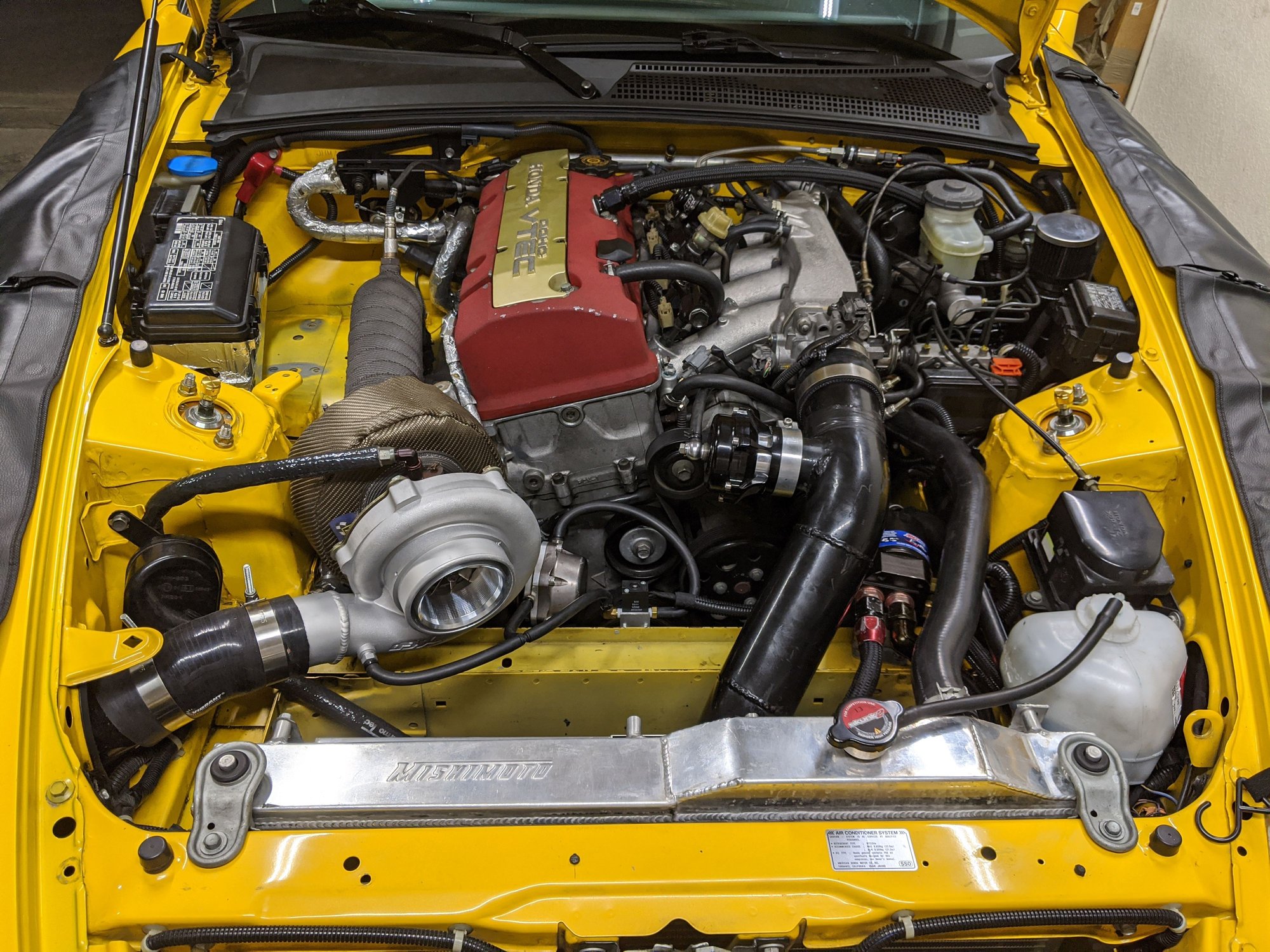

I’ve posted a couple times but made some small changes and went back for a tune up in the hunt to hit 450whp on pump gas. Relevant mods for my 2005 include an original F22C shortblock w/ 152k miles. Headwork is <5k miles, new OEM valves, Supertech TI springs and retainers and bronze exhaust guides. No port work, OEM manifold and TB. Compression is over 215 in all four cylinders.
Kings Performance gen 1 sidewinder manifold w/ T3 connection into an AGP Z2 6262S Journal Bearing turbo, which is a 62mm turbo. I’ve got the OCDWorks T51R Mod on the compressor housing because I grew up in the glory days of the big (back then anyways) single turbo supras and skylines, so the whistle is nostalgic and awesome. Precision 750HP universal intercooler w/ 2.75” piping. Straight 3” downpipe/midpipe (no cat) to a Ballade 76mm catback. EDIT: I had a 4" AEM intake filter for the dyno run.
AEM v2 ECU w/ 3port boost control solenoid. Held steady 18psig. TX 93 octane.

Mine's yellow, his is silver.
KP Manifold, AGP Z2 6262S. EDIT: I had a 4" AEM intake filter for the dyno run.
