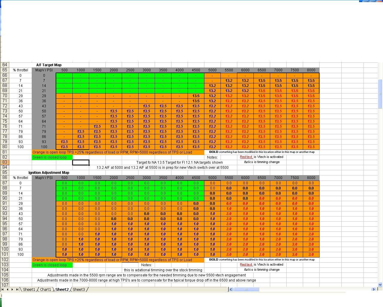

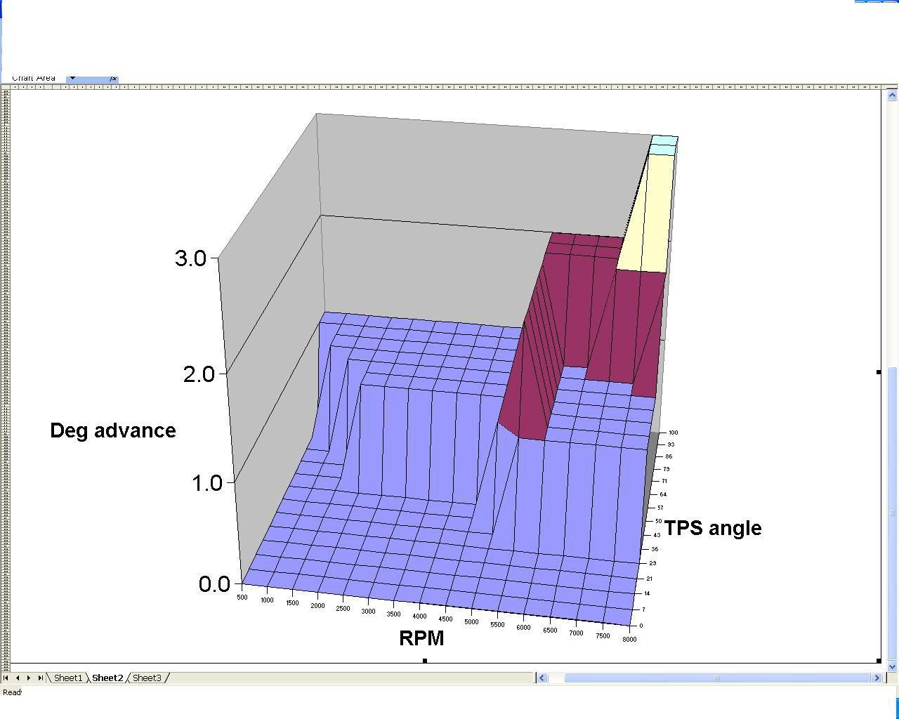

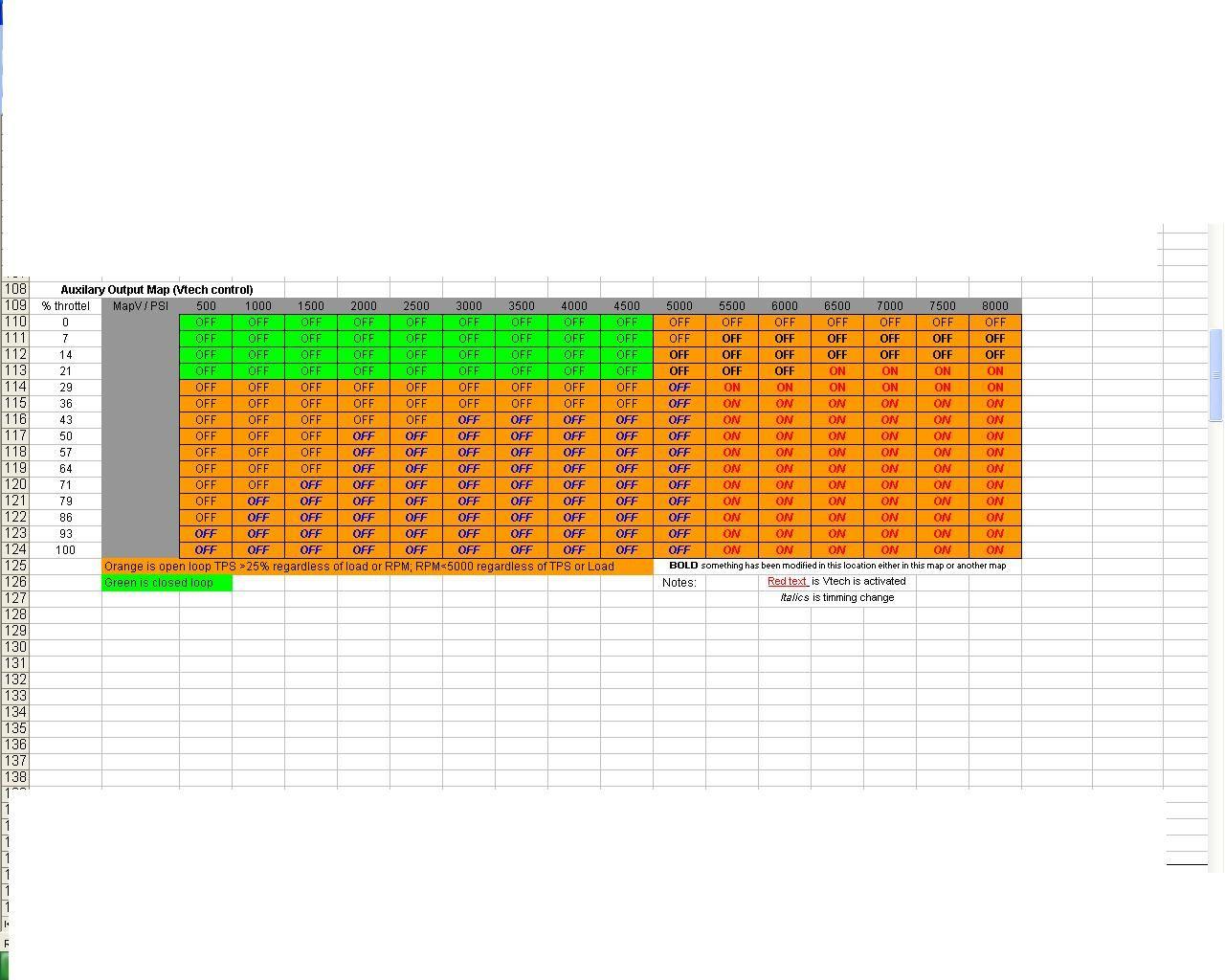

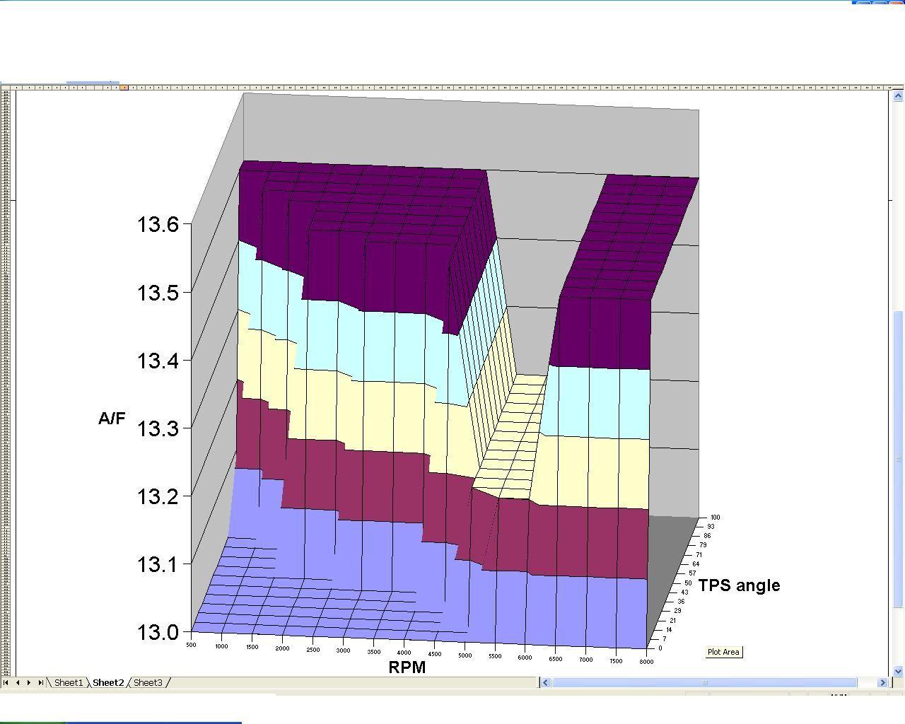

Just some thoughts I have been putting together.
Lower Vtec to 5500 with appropriate timing advance in that area.
Tuning will start with A/F target map.
see what power can be gained
Then a Vtec adjustment
see how power is affected
Then I will start fooling around with timing control.
Just some numbers in my head A/F is richened up as a precautionary measure for the new vtec point until i get a handle on the timing for the increased air flow.
TPS is being used for the pictures untill I get good MAP voltages/pressures to put into the maps.
Since no one else is using the e manage ultimate I guess I am going to be the first to experiment with it.
