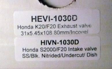

I have also done another bought through Laskey using Supertech. This head got their Inconel Exhaust Valves, Nitride Coated Intake Valves, Springs and reatiners and last but not last valve guides. With the mileage on your engine the guides would not be a bad idea.

I went with supertech thru Mike Laskey got dual springs and ti retainers, standard sized inconel valves both ex and in, and new seats for 625 shipped. they should be here on Friday

I'm surprised they make inconel intake valves they are heavier than stainless and offer no advantage that I could see...
The advantage is Inconel. Inconel maintains its strength to 1800 degrees and is ideal for turbo applications where there is excessive heat. Stainless just wimps out.
