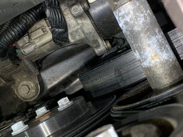

Guys, I have a 6.5" custom made crank pulley by ASP, Texas. I have a Vortech V2 on my AP1 with a 4" custom made pulley by ASP as well. I have had the blower belt rip about 5 times now and twice it took the OEM serpentine belt with it!
Here's what I have checked:
- pulleys are all aligned
- pulleys are in good condition
- last time the belt ripped I think I set the tension too high and I did that because the previous time it ripped I think the tension was too low. This time I made sure to tension the belt to 1/4 turn or 90 degrees twist as per Vortech's instructions but again, the thing ripped, slipped or whatever else it did to put me in this position...
It held up to a few 9 grand pulls just fine until suddenly there was smoke and strange noise. The blower belt had ripped and was clean off the blower's pulley. The OEM belt was tattered and torn as well but still remained on its pulleys.
Why am I having this problem? Could it be that the clearance between my crank and water pump pulleys are too tight? I am wondering if while driving and pushing hard, the belts collide with each other when one or the other stretches even just a bit during shifts???

Get the cheapest belt you can get, put it on, tighten to the same spec, do one or two runs to 9K and stop. Inspect the belt for damage. Might give you a hint on which side is getting chewed up and compromised. From there you can investigate further.

I have crank pulleys from ASP as well and it's about as tight as you can reasonable get. It's hard to tell from the pic, but there is about a dime's width space between crank and water pump pulley and they also overlap (so I have to take off the water pump pulley for the OE belt). I've driven the car from Indiana to Pennsylvania and back and then to Texas and it's never chewed a belt so I don't think it's your clearances.

Might need to drop back down the 6" crank pulley and run a smaller blower pully to maintain your current boost. If the pullies are indeed in alignment, I suspect there is some interference somewhere if not totally obvious stationary, things expand and flex under heat and load.

My clearance is just as tight! I also need to remove my water pump pulley to remove and install the OEM belt! Your experience shows that it can't be the problem. I think i may have found the problem now. I didn't have a washer on the lock nut for the tensioner pulley. I realized that now so i installed one and immediately it caused the tensioner to become nice and flush with the bracket when i test fitted it. This may have been the alignment problem all along! I need to test it tomorrow and see for sure

I think i found the cause. Missing washer on the tensioner pulley. Hopefully that did the trick this time.
I also notice that my Vortech tensioner pulley is not flanged. Only the idler and blower pulley are flanged.
