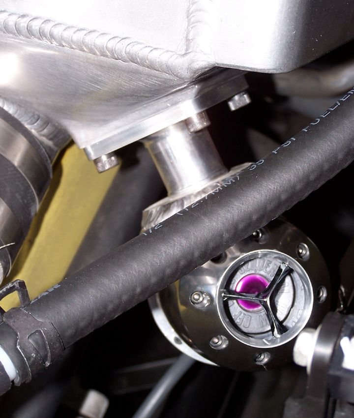

I have an HKS BOV on my Comptech. It's not a direct bolt on. We had to fabricate a mount for it. The first version didn't last very long,(it snapped off the mount) due to engine vibration and the length of the shaft we used to mount the valve. Version II is working just fine, with stronger welds and some extra support I'll see if I can find a pic of the valve and post it up.

Here's Version I. I'll have to take a pic of Version II

- FINALLY someone has posted a pic of a fabbed BOV.. thanks
