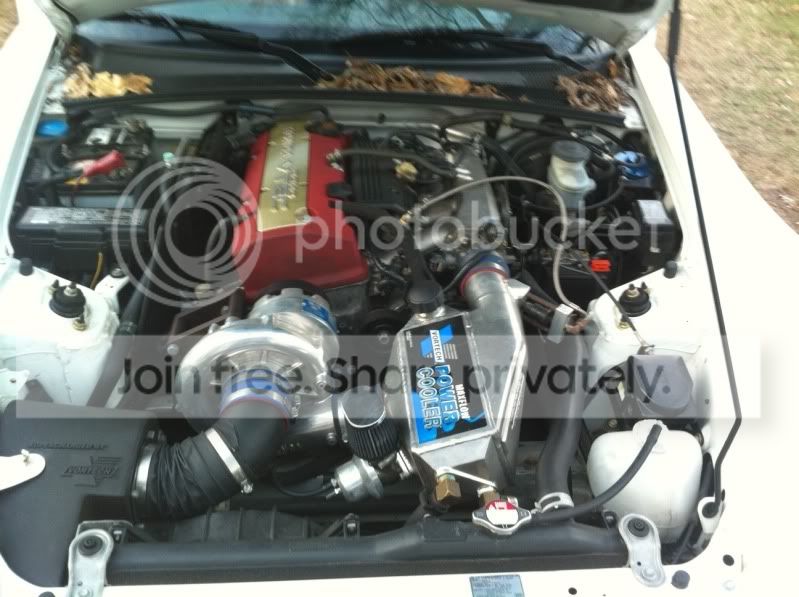

I've always been curious where/how they tie in that 5th injector on this kit. Some pics would be great if you can post them
You will likley see 7.5-8psi at most with that pulley. Good for a bit over 300whp Dynojet.

The fifth injector is installed on the Aftercooler right before the TB. Here is a pic of it installed on a members car that I got the kit from.

Thanks for the pic, kind of a strange looking set up VT worked out there, especially considering the stock injectors with the appropriate adjustable fpr will supply enough fuel to not need it. Looked like a serious bung welded on to the AC. Is that how you get it from VT or do you have to get that welded on I wonder?

From my understanding that is how the 04/05 vortech kit is. Just mount the injector into the bung and your in business.
