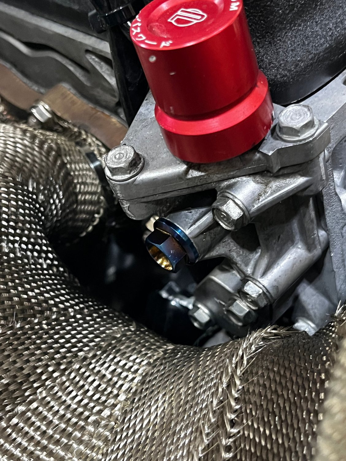

I've melted my sensor more than once. From my turbo header. I’m done replacing it. I want to tuck the wire , delete the sensor and by pass. I do have a Hondata tuner. Can any one help me out??? Just need to know what to do.

If you don't need to run the sensor since you're on Hondata then just delete it. Carefully cut open the wire loom, cut off the wires to the sensor and seal them with either electrical tape or something equivalent and buy this plug on ebay. Or source one from this OG post.

Yes the car was parked and i was adjusting my tune. Thank God !! Well, the disable works perfectly to turn off the oil switch. So just pull and tuck the wiring. Done and done. I cant recall where i bought it from. . Ill look and get back to ya. Was only 20 bucks. Burt titanium. I like it. Ill find the link and post it!!
