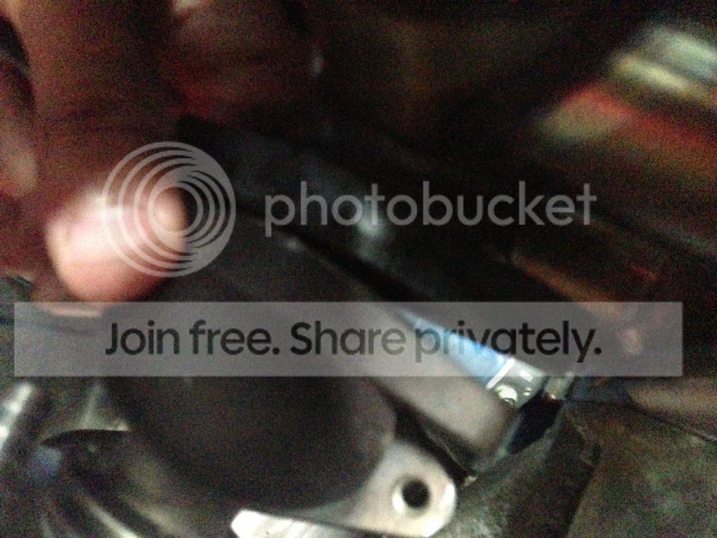

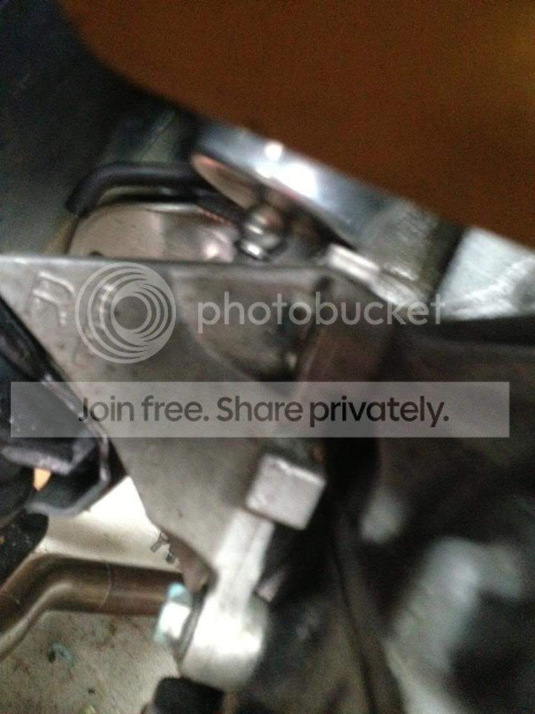

Old Aug 29, 2013 | 06:41 AM
ldiaz's Avatar
Joined: Jul 2010
Posts: 68
Considering cutting off the piece in the red so its more of a tighter fit. Sorry for the terrible quality pics an iphone was the only thing I could fit in there.
Old Aug 29, 2013 | 06:48 AM
herecomesboost's Avatar
Joined: Mar 2005
Posts: 4,692
Likes: 6
From: Centreville, Va
So the air fitting has clearance, but the wastegate housing is touching? I would shave/cut the engine mount to gain enough clearance.
Old Aug 29, 2013 | 06:55 AM
ldiaz's Avatar
Joined: Jul 2010
Posts: 68
At first I thought it was the fitting but the picture showed me I was wrong, ill shave it off and see what happens.
