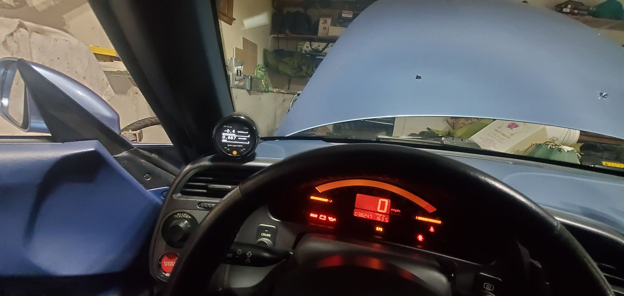

I'm using one of the GaugeArt CAN gauges that SoS sells. I love, love, love it. I can set alarms, min and max values, monitor tens of parameters, etc. Paired with an Infinity 506 ECU for those curious.
Also, I like the gauge where it's at for easy reference, rather than down by the engine start button where the audio controls are.

I like this setup a lot. Where did you get that stand/mount? Does it come with the GaugeArt?

Thank you! I think I got it from either Amazon or rallysportdirect, just some cheap 52mm pod. I wanted something adjustable and easily relocated if I fancy a change. Unfortunately the GA didn't come with a pod.

I'm with the others who recommend the SOS gaugeart can gauge. I'm monitoring oil and fuel pressure along with everything the ECU sees. I also sometimes use it for a shift light.
I ended up 3d printing my 52mm pod. This is a great spot for my gauge.
