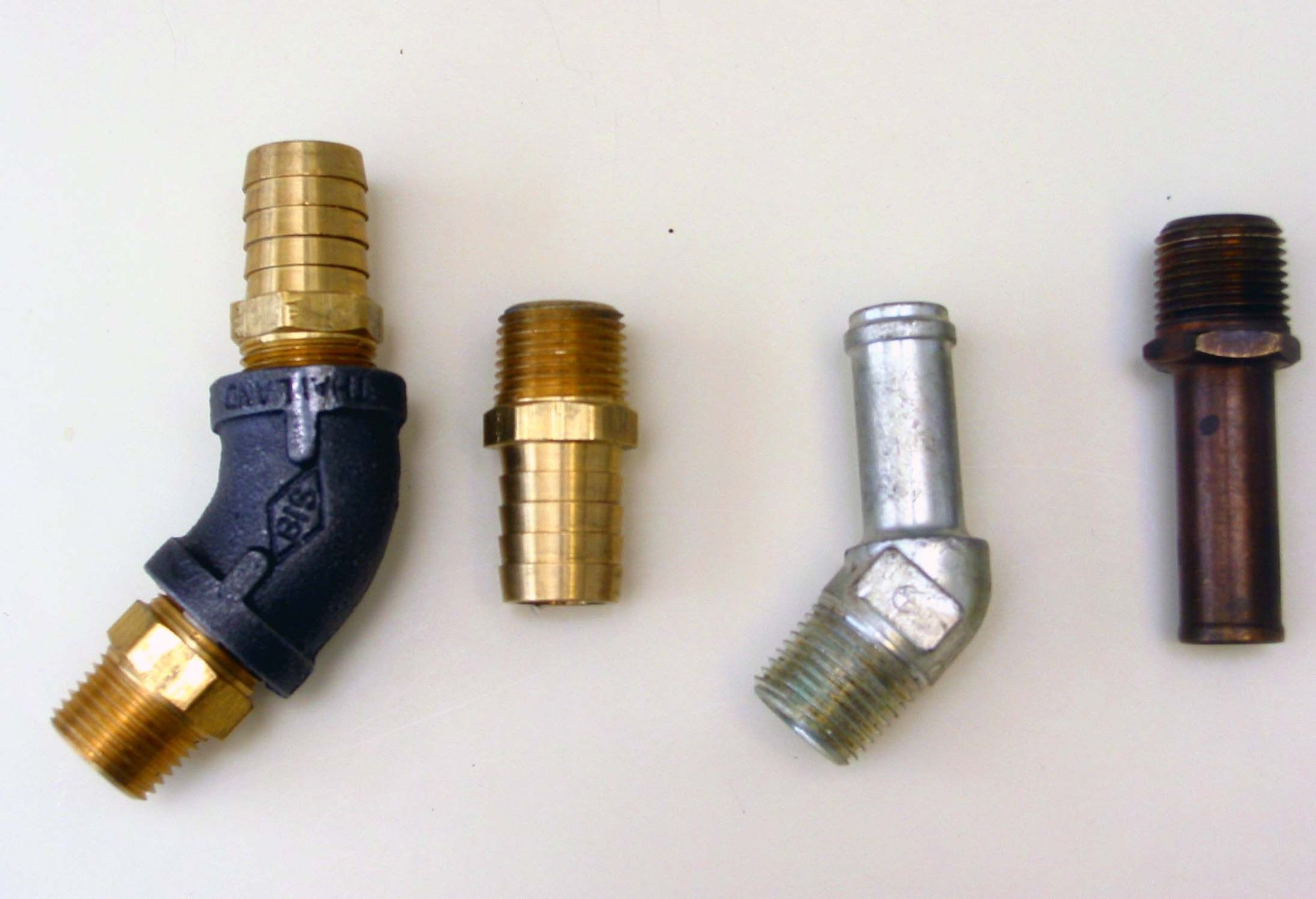

Order this fitting and tap it into your oil pan right under the turbo center section as high on the oil pan as possible:
http://www.amstreetrod.com/984404ERL.php4
Here is a picture of the fittings I used, and they were tapped into the oil pan:
The two on the left came with the UR kit; the two on the right is what I used.

Thanks alot guys. I was beginning to feel like an idiot since no one had brought this issue up before. Since I can actually go through the pan I will use the UR fitting for now on the stock pan. The Mugen pan was going to go on but I'll just wait until I get some nice braided line and AN fitiings later. The turbo won't even be connected until the tuning.
