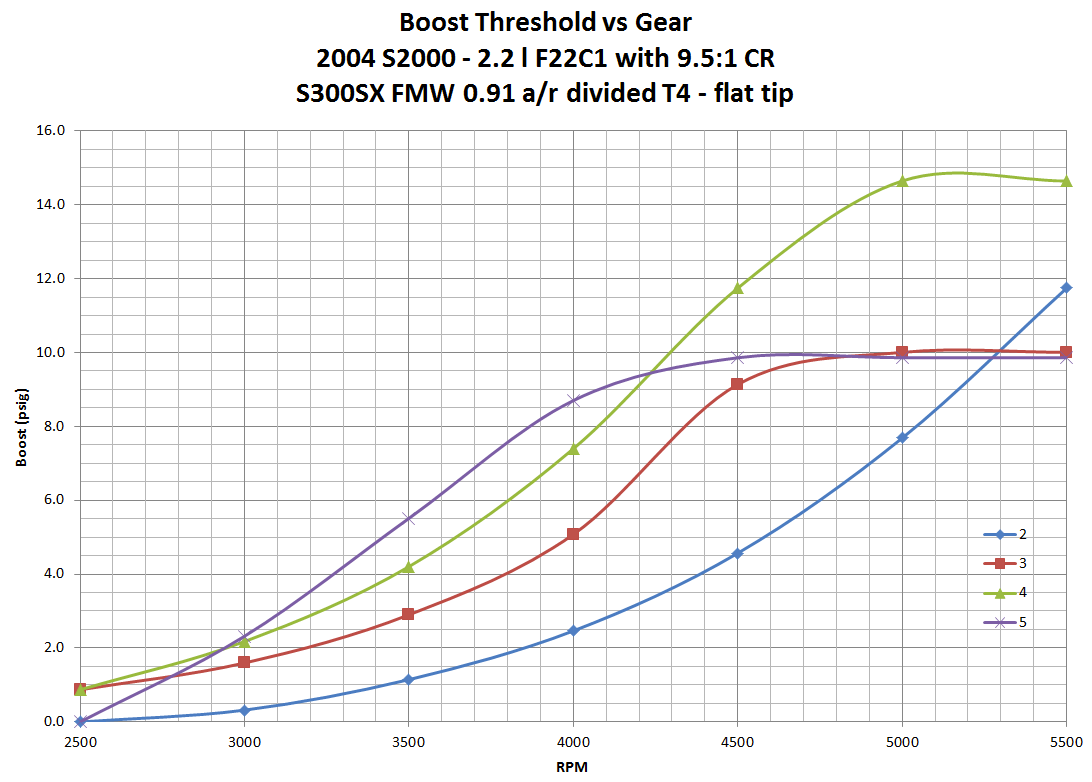

Here's an example of a relatively large but by no means giant turbo on a S2000. IMO, this is a medium frame size turbo on a S2000. It's one frame size larger than those mentioned above, but still spools pretty well- more like a GT35R in most cases, but a GT30R in the best cases. Arrival of boost is based on time and load. In low gears, boost won't arrive until you're well into VTEC. In high gears, you can have full boost by 4000 rpm.

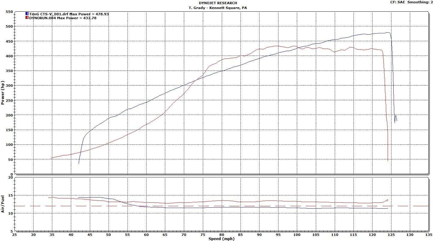

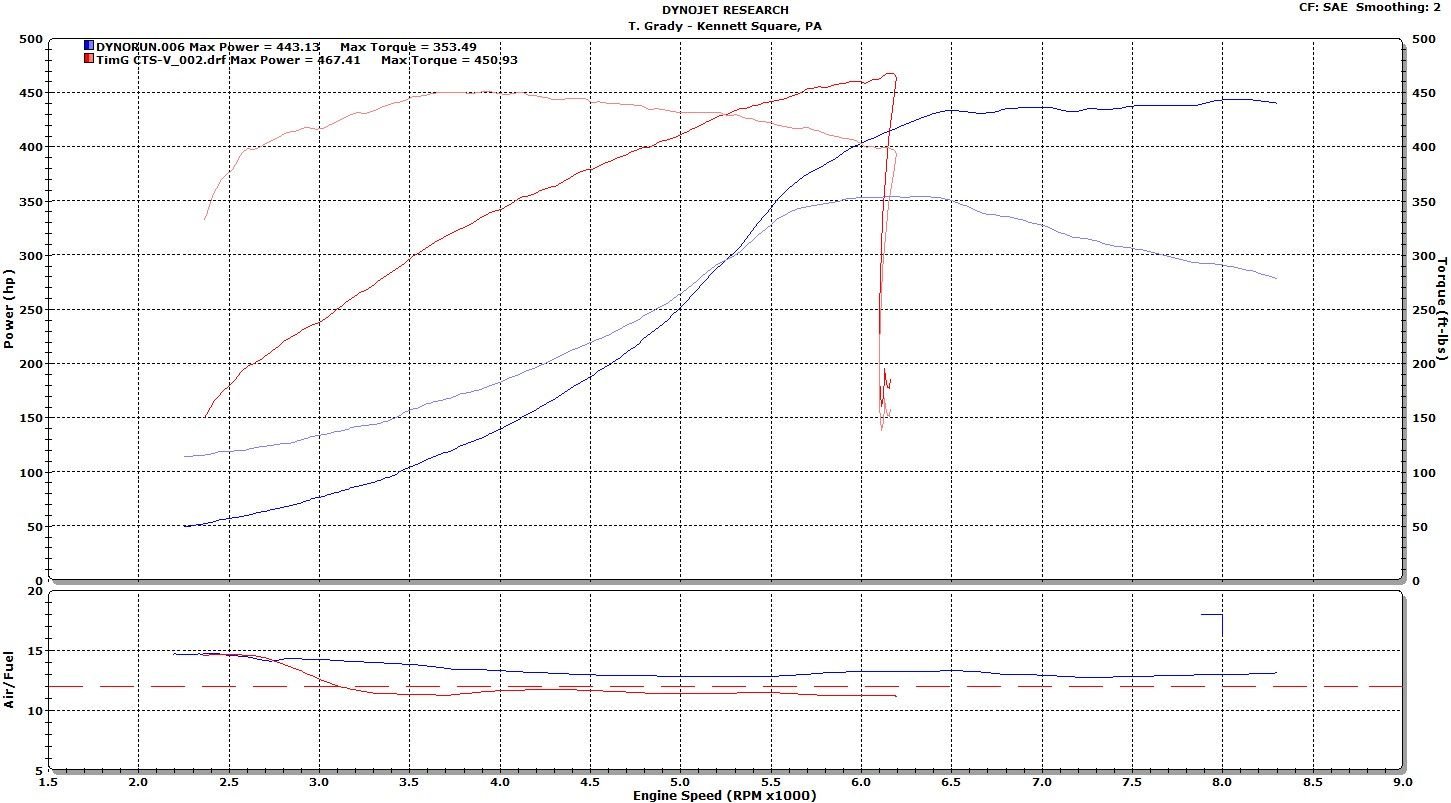

Here's another example of Roots vs. turbo. This is a relatively small GT3076R (1st gen) S2000 vs. a 100% stock CTS-V LSA with a TVS1900 supercharger. This does a very good job showing how the power bands of something with a PD supercharger vs. a small, relatively fast responding turbo compare. The GT3076R is a bit laggier in this dyno than normal because it was a Dynojet, at high elevation, and with low compression. I have other dyno charts from a load bearing Superflow dyno from the exact same day showing 1000 rpm faster spool... On these charts, the GT3076R power was falling off due to boost tapering from 16 psig at the torque peak to 10 psig by redline. This was due to maxed out injector duty cycle.
