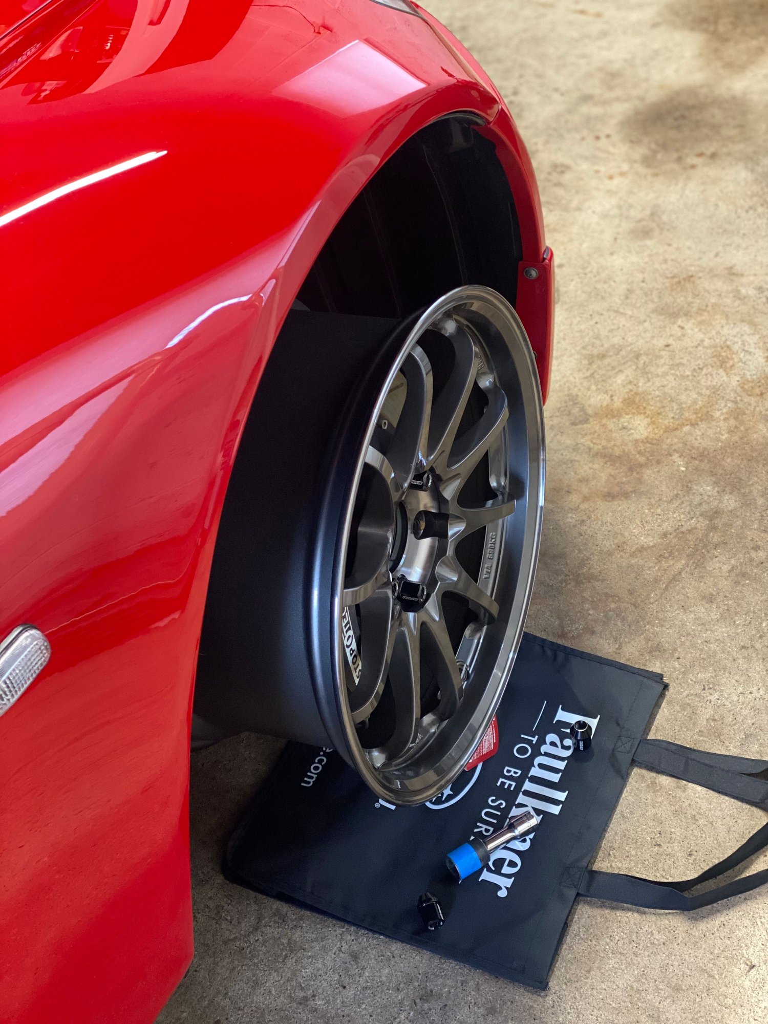

I’ve had very little luck with sourcing a used set of CE28N OG spec, so I ended up purchasing a set from Idleboost in Texas.

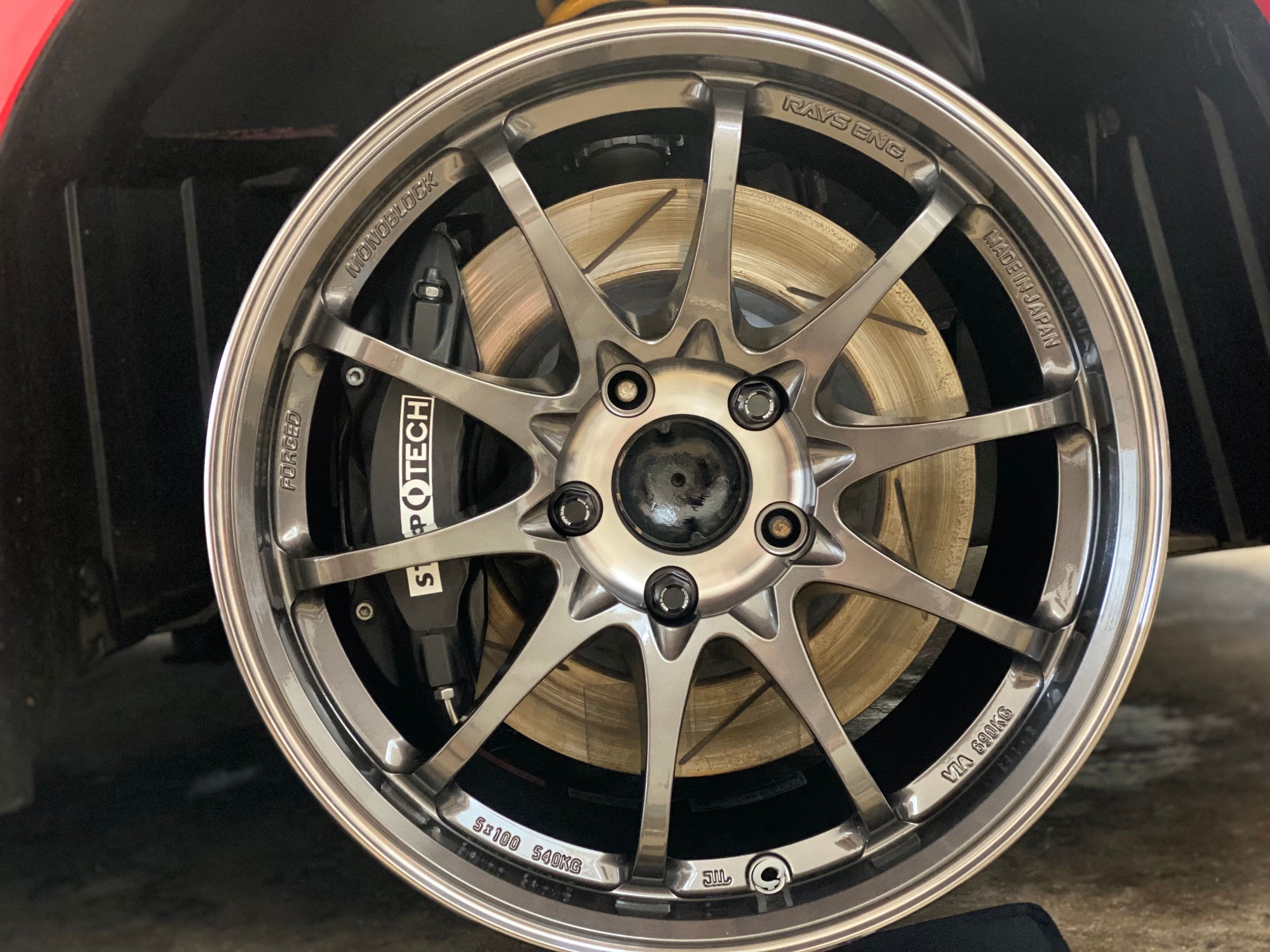

So far as expected with the 328mm rotors, the Face 3 concavity makes it difficult to fit without some sort of modification. So far, they touch the face of the caliper very slightly, so I ordered 3mm spacers to clear.
Here’s a sneak leak of what to expect on the NFR. Soon to be wrapped in 255/40/17 RE71rs’s. More to come!

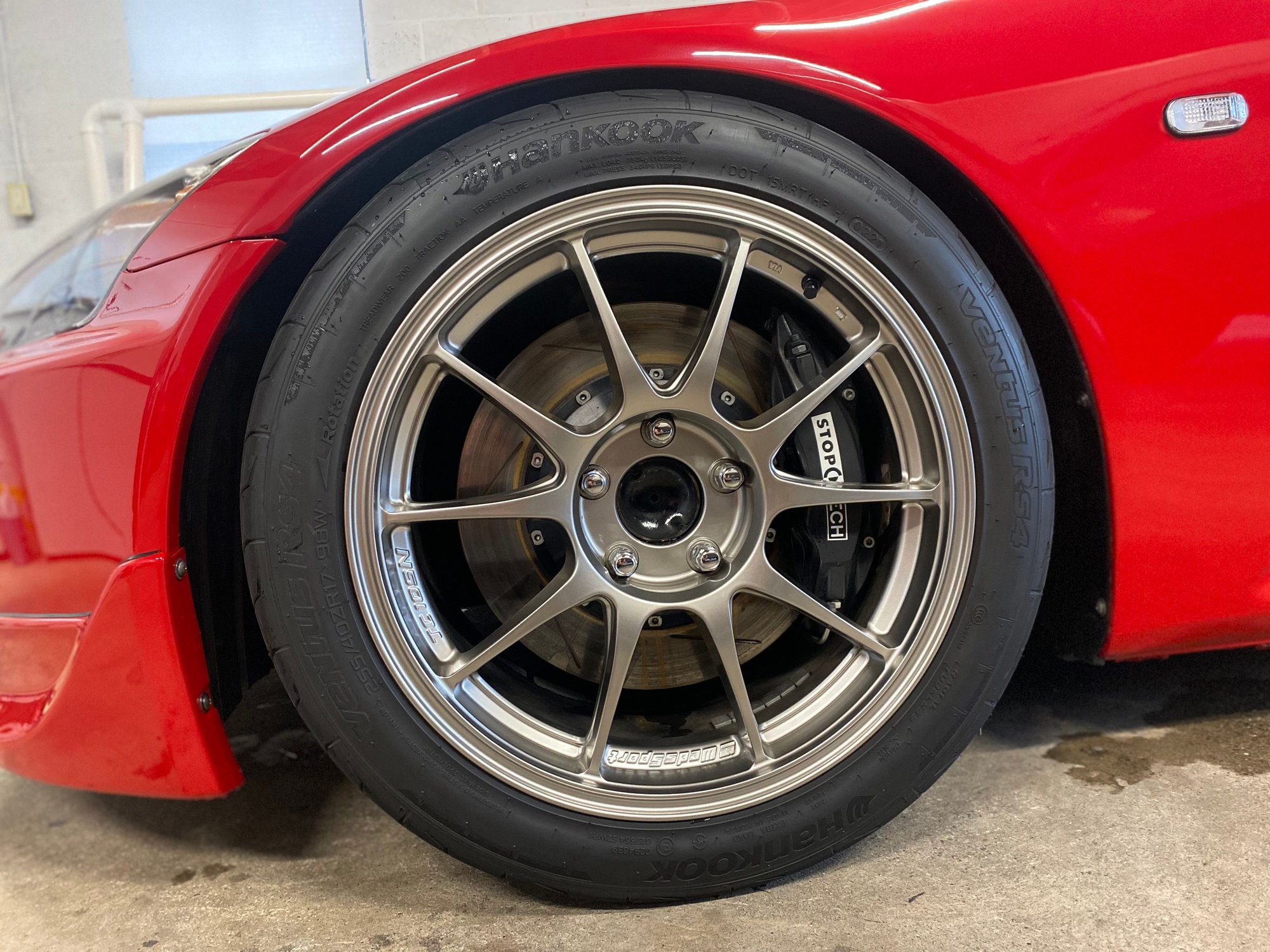

Yeah, 255. I’ve ran the same tire size on my WedSports for the past 4 years except they’ve been Hankook RS4s. So I’m excited to see how these will sit and handle in high temps.

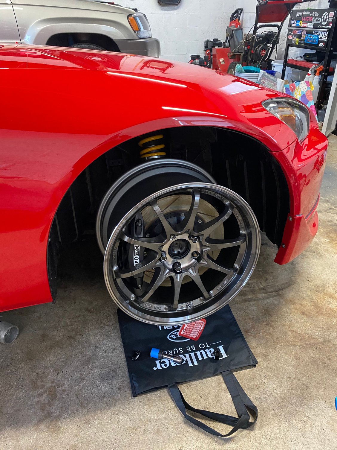

May end up raising the fronts 3-5mm when the new wheels are on. Spacers arrived today, so I’m hoping to test fit today as well.
UPDATE 12/11: 3mm did not do the trick, 5mm it is...

I will have to check again once I receive the 5mm spacers. I pancaked the two 3mm spacers together to simply check clearance and it cleared the Stoptechs with room to spare. I didn't tighten the lug nuts, so I will have to test it next week and let you know. If the studs are too short, then I guess I'll have to order ARP extended studs now too.
