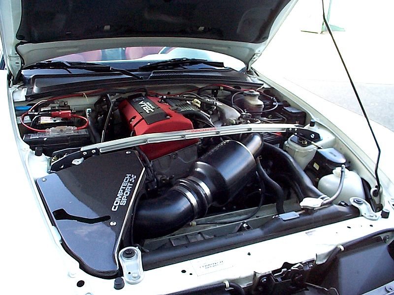

Heh heh, ok it was just a CAI and STB. If anyone is planning on installing the CAI, be sure to disconnect the factory air lines (there's a bunch of them) CAREFULLY. While I was yanking one of the lines, I broke one of the connecting nipples. I had to buy a new air reservoir chamber for $20. Anyways, here are some pics:

How does the cold air enter the new airbox?

The air enters through a factory hole in the fender wall. This is the same chamber that other CAIs get their air from.
