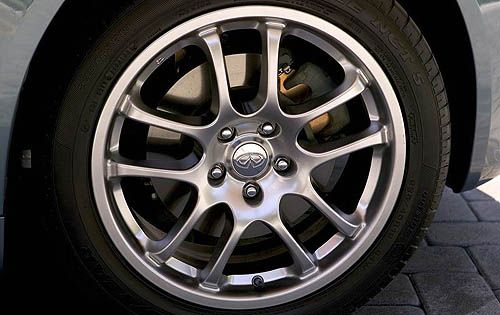

A couple of weeks back I started thinking about this combo

Do those wheels come in the correct offset and bolt pattern? Will you still have a staggered setup? Personally I don't like it; too "blingy." But it's your dime.

Those wheels don't have the correct offset for the s2k.

i was thinking tha same thing cuz my friend has a g35 and he wants me to try his wheels but i dont think its gonna fit back seems too wide and also g35 has a lower offset then s2k...
and im not gona raise my car for wheels

its the same lug pattern but those wheels will stick out too much they're +30 or somethin like that, u need +48 and more for the s2k,

Yeah...I'm gonna say NO.

i asked this way when i first purchased my car... they wont fit because of the offset. thy'll eat up your fenders if you'ld try...
but my buddy has a black RX8 with them on painted black with a chrome lip... they look SUPER SWEET!

I put some 350z front wheels on the back of my car 1 time. they were 18x8 et30 with 225s and they barley fit with s-techs.(i did not have my flexes yet)
