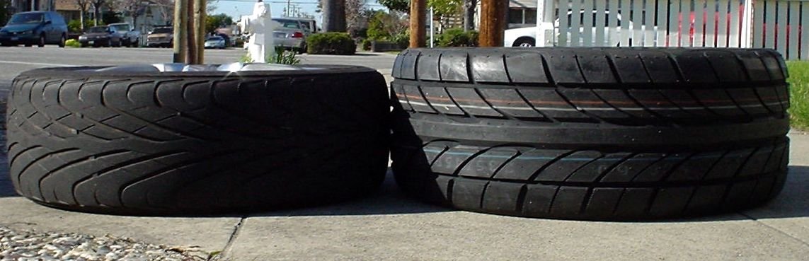

I fit the 235s today. As the picture shows--compared to stock the 235/45-17s are f-ing massive:

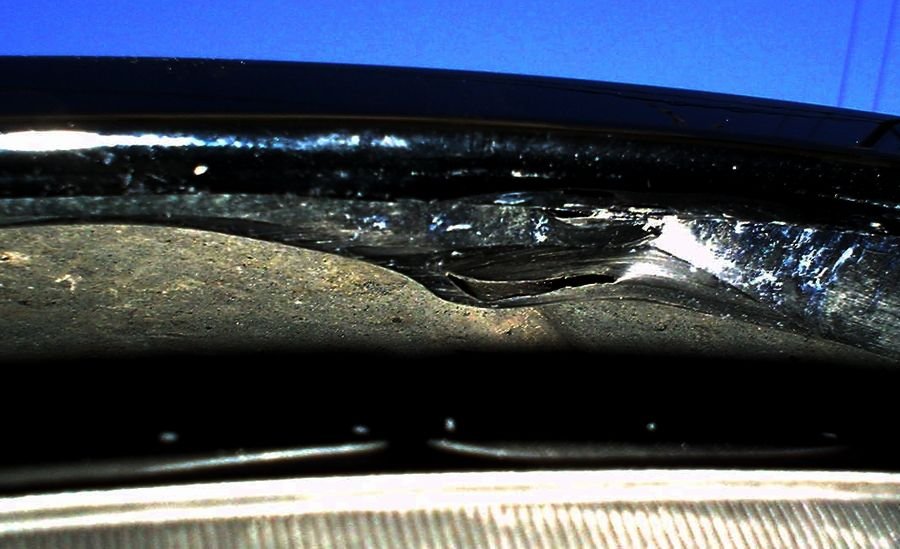

They fit fine for mild street driving even with a ~30mm drop, but under even mild cornering loads they would rub. I raised up the Teins a bit (still lower than stock) and uncovered what I think is the main source of the problem---though the lip on the front fenders is way smaller than the lip on the rear fenders, there are tabs under the fender guard that stick out about 15-20mm. So I popped off the top most button-tab thingamajigs, pushed the liner back and above the metal tab.
With 225s I would hit the fender guard and with larger diameter 235s I wore right through it. Instead of using a bat, I just heated up the fender and used a crowbar to push the tabs back which also held the fender liners nice and tightly:
The result is hard to see because it worked so well--the offending tab is pushed way up into the fenderwell.
The plastic still sticks out a bit, but the tires don't rub. I was tempted to take off the liners completely, but as instructed by Asura--if you take the fender liner off the tires will throw rocks up into the fenderwell and dent the metal/crack the paint of the fender (on both sides).

Wow. That looks awesome. I can't wait to get the 235's on mine.
