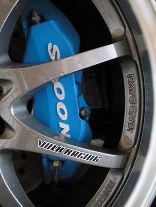

[QUOTE=GPWAP1,Jun 6 2007, 06:31 PM] u got the brakes the other way around.

nevermind, this was my old setup.

Originally Posted by GPWAP1,Jun 6 2007, 06:31 PM
u got the brakes the other way around. black cap should be facing down, lines from bottom not top.
what are you talking about?
nipple will always points up, look at all the cars's caliper.
if he nipple is point toward the earth the air will never able to escape

Originally Posted by stevespai,Jun 6 2007, 05:40 AM
I had some time today and decided to tackle my BBK. However, I only had time for one side. I'll post some better pics once I get both sides on and get outside. Enjoy!
-Here's how the looked before. I've been staring at them for a few months now.
-Installed
Can someone tell me if this is correct? I just ran the SS brakeline straight up.
THe bbk looks great, just like the one it installed for the lexus is last week.
btw what series of pad are you running?

Originally Posted by stevespai,Jun 7 2007, 09:18 AM
Can anyone comment on this before I do the left side? My purge valve is facing up (no?). But which way should the line face (up or down)?
it doesn't matter where the line face, it's a close system
if you have bubble in the line you are in trouble
