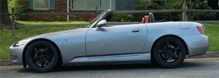

Got the springs on, what do you think?

Which springs are you using? Did you compromise the ride quality, not that the S has any kind of ride quality. I would like to lower my car as well but and worried that the car will ride rougher than normal.

I got KG/MM Race springs and yes you can notice. Its definitely feels better taking turns, and you can notice bumps alot more.

wow! black rims with sebring.. looks diff.. nice.. to balance the rims, top on would be necessary for future pics..

Your car looks cool as hell. I love that look. There is nothing cooler than black wheels on a silver or white s2000. Some people like the jdm look some dont but I think it rocks

very nice patrick!!! i thought your car looked nice b4, now it looks waaay better. can you pleeeeeeeeeease post the alignment specs when you can?! haha looks like im gonna have to take my lip off when i get my springs in...

Car looks great.. since you really want comments..
FWIW, two things I have noticed when doing suspension work; 1) the car is very short on front suspension travel so I recommend a max of about a one inch drop.. you can and probably will bottom the front suspension with spirited driving unless you can stay on perfect surfaces, 2) the car is well balanced so lowering one end more than the other has a big impact on handling, I recommend trying to keep the change the same, 3) re-alignment is a must with a height change.

I've had the stock shock and KG/mm combo for almost a year now with no problems. I brought mine to Curry's in Chantilly VA for alignmet.

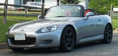

Some more pics from today, actually cleaned the car....
