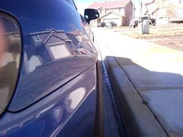

How much would a 10 inch rear stick out from the quarter panels? Or is that determined by the offset as well?

how much the wheel sticks out depends mostly on the offset. you can also affect that by running different camber to help the top portion stick inwards towards the fenders.
here is the 10 +35offset with factory camber and 255/40 pirelli tires.
add about 3.75degree camber and i can get this thing to stick in

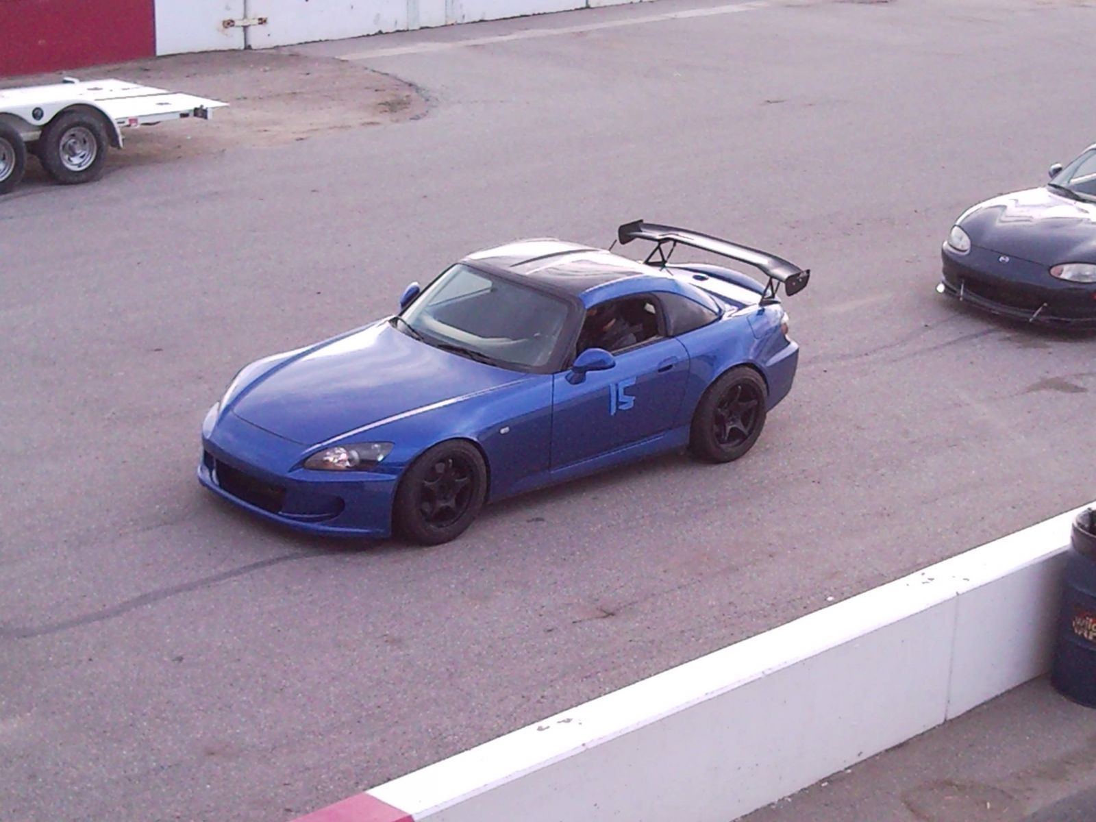

17X9 +43 17X10 +35 255/40 R1R X 4 -2 camber, little flare
