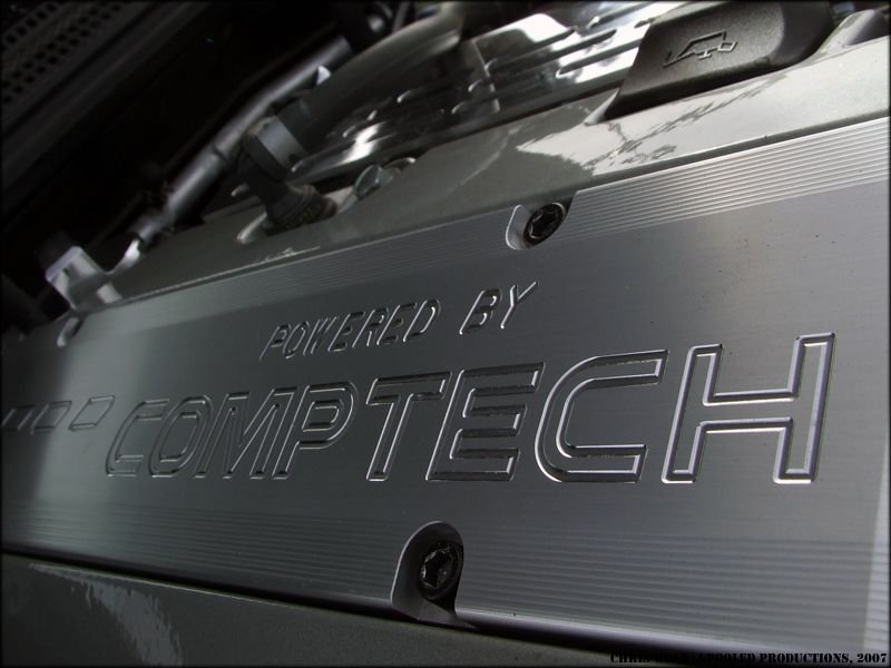

Thanks to Comptech. Valve cover is powder coated, sorry.
