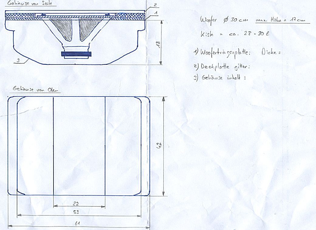

On the beginning of my project, I provided the following sketch (the numbers are in mm):
The closed housing should seize 28 litres, in approximately as much as the IT12 Cerwin Vega Woofer needs. You can fill it with water before you close it in order to go surely. But caution, each Woofer possibly needs another volume, equally it depends on whether it concerns a closed housing or band-pass.
I have documented the whole thing during the building phase... Unfortunately only in German, but with Babelfish you can perhaps read it, if youre interested: Link
PS: that is perhaps not a very professional example, since I made it for the first time. But it works as it should and it doesn't look too bad... That is the main thing in my eyes

Very nice write-up
Unfortunately, I'm terrified of fiberglass
Oh and thanks for the Babelfish link...aber ich spreche Deutsch auch
