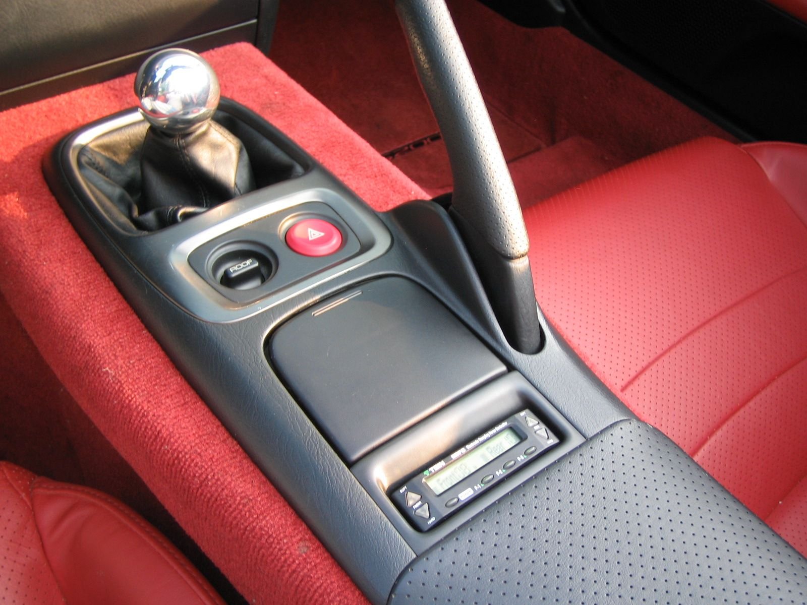

Yeah, don't mess with the upper perches, that was my mistake! I think I have it all sorted out now, though... just needed to raise up the upper perches in the rear. It felt bouncy before, but I just took it out on one of my favorite roads, and it is feeling much better. Seems backwards to me from everything I have been reading about preload, but I think I was just thrown off by the helper (tender?) springs when I set it the other day. I'm still curious about the initial measurements from Tein, though... anyone with them still in the box want to measure?
As for ride height, I have been adjusting it on the bottom perch by unbolting it from the A-arm, and raising/lowering it there.
Here are a couple of pics... about 1 finger gap in back, 1.5 in front. Once the springs settle and I get the new wheels on, I will mess with it some more, but right now, I am very happy with it.
And, of course, the EDFC in the standard AP1 mounting position
