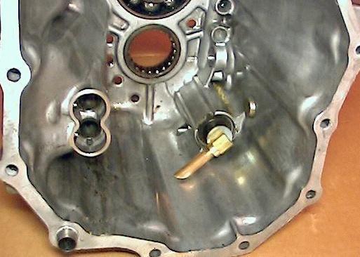

The little stamped steel pickup that can be changed quite easily:
The fluid levels at rest, remember this is before the system is filled (main and countershafts with pressure)and of course not cornering . . .
Top line is the fill level, at the bottom of the filler bolt. Bottom line is the pickup opening.
This is where I mounted my pressure sensor
Another angle from inside for the sensor mount

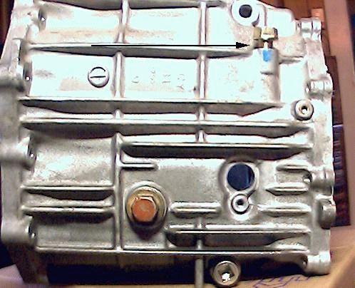

Here is my fix for the oil pump
The green arrow points to where air would first become a problem
Blue lines are levels compared to the photo above
Red lines would be approximate safe levels when cornering(to the left)
approximate because I dont know the volume of the reserve at speed

For those following these tranny threads, I came up with a better fix than pictured above.
It basically sumps from the drain bolt through a filter and cooling system and back into the pump pickup.
Im still running on the OEM replacement tranny, overfilled by lifting the rear 1" at the diff. NO problems so far.
I believe the new tranny is the same as my first and second, it's just . . . well . . . how often do you get to run over 100mph for a day?
But anyway, as far as I can tell ALL S2000 tranny's have the intermittent problem. I still have no clue what they did in Europe.
