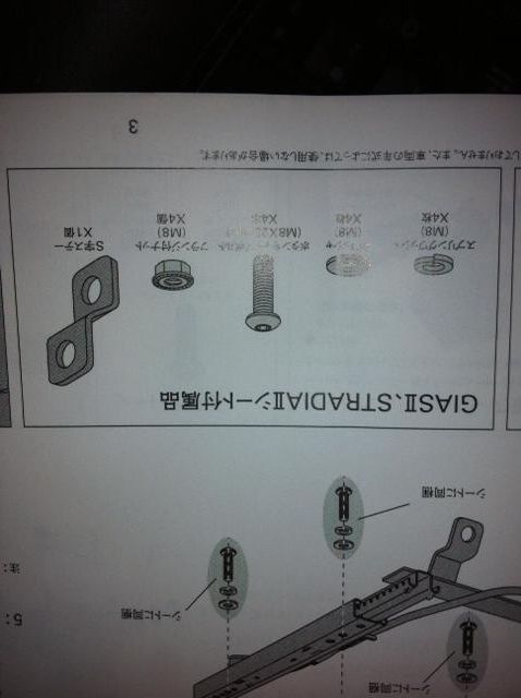

hey everyone, was wondering what most ppl are doing for this, i was looking in the Bride LR rail but its shown it has no bracket to mount the seat belt buckle, i tried looking on Bride Japan someone said they sell the bracket, but coulndt find, can you guys tell me what you guys are doing about that, possibly show a picture or two, Thanks!

found out this is the bracket i need to put the receptacle buckle in it extends it out to mount the buckle anyone know where to get it? i even tried looking at hardware stores and home depotcame up with nada

buy a piece of 1/8 thick by 1/2 wide steel flat bar. cut to your needed length, bend to match, drill 2 holes, mount your receiver with hardware. cost ya less tan 10 bucks and you can do it in an afternoon easily.
