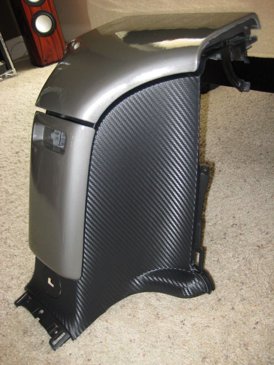

Secret compartment console, painted & wrapped

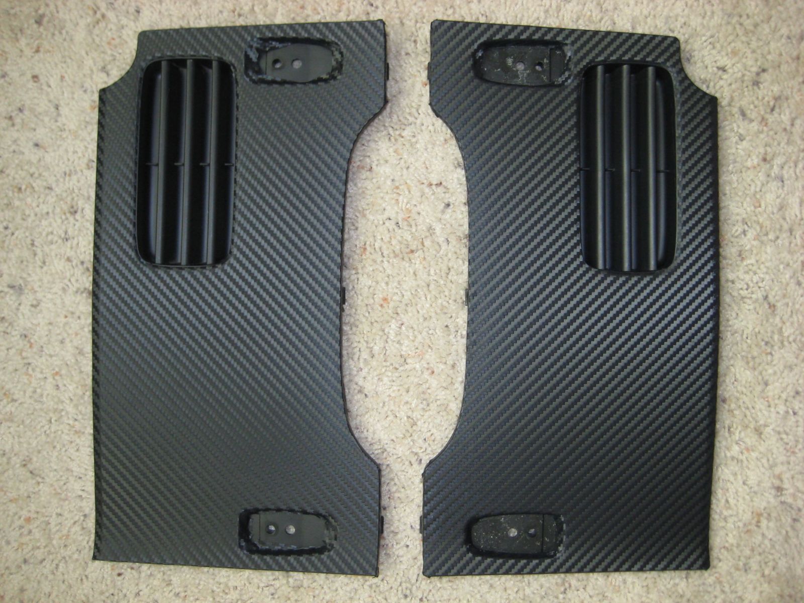

Rear vent pieces, about the easiest to wrap

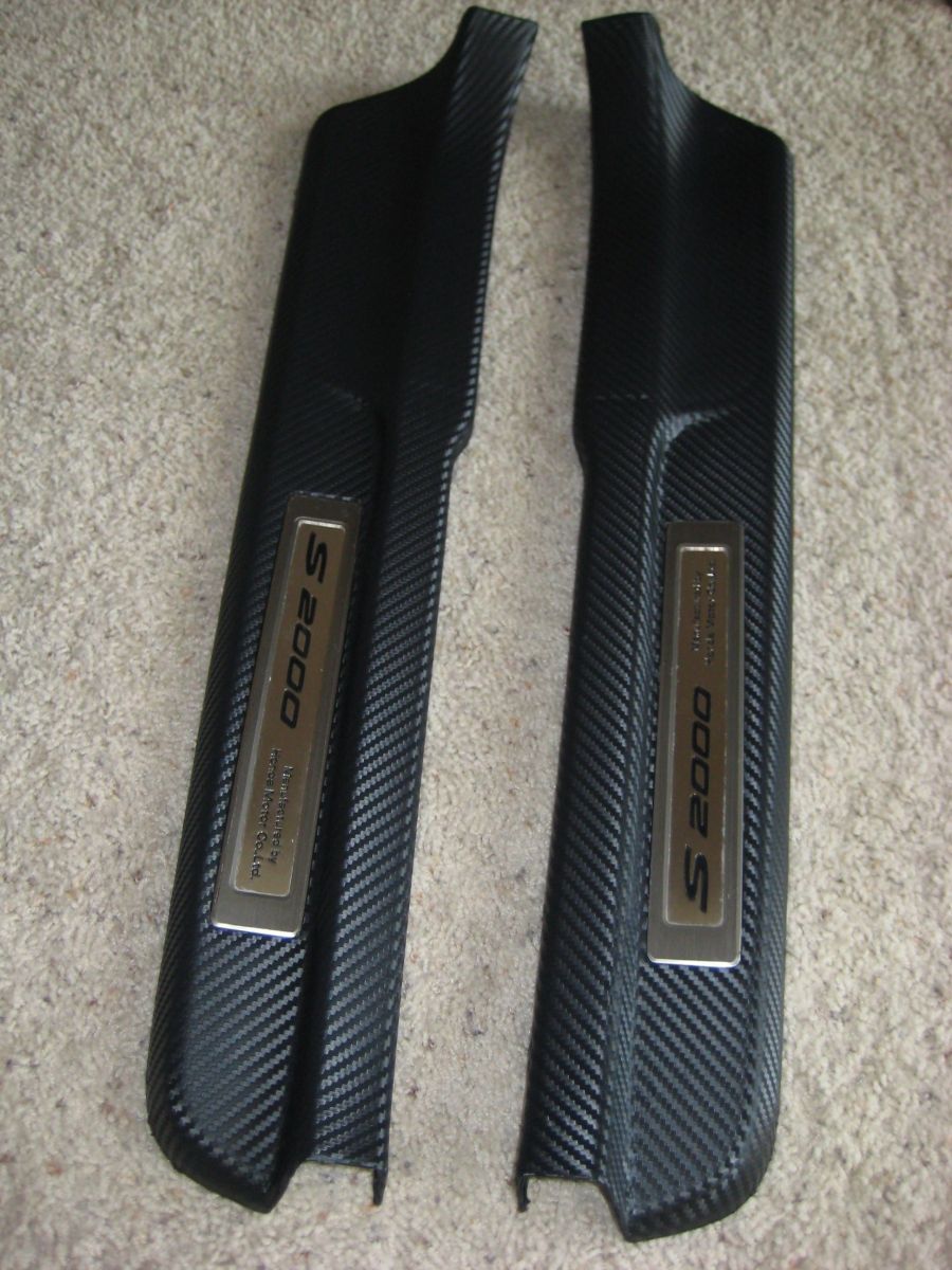

Door sills
