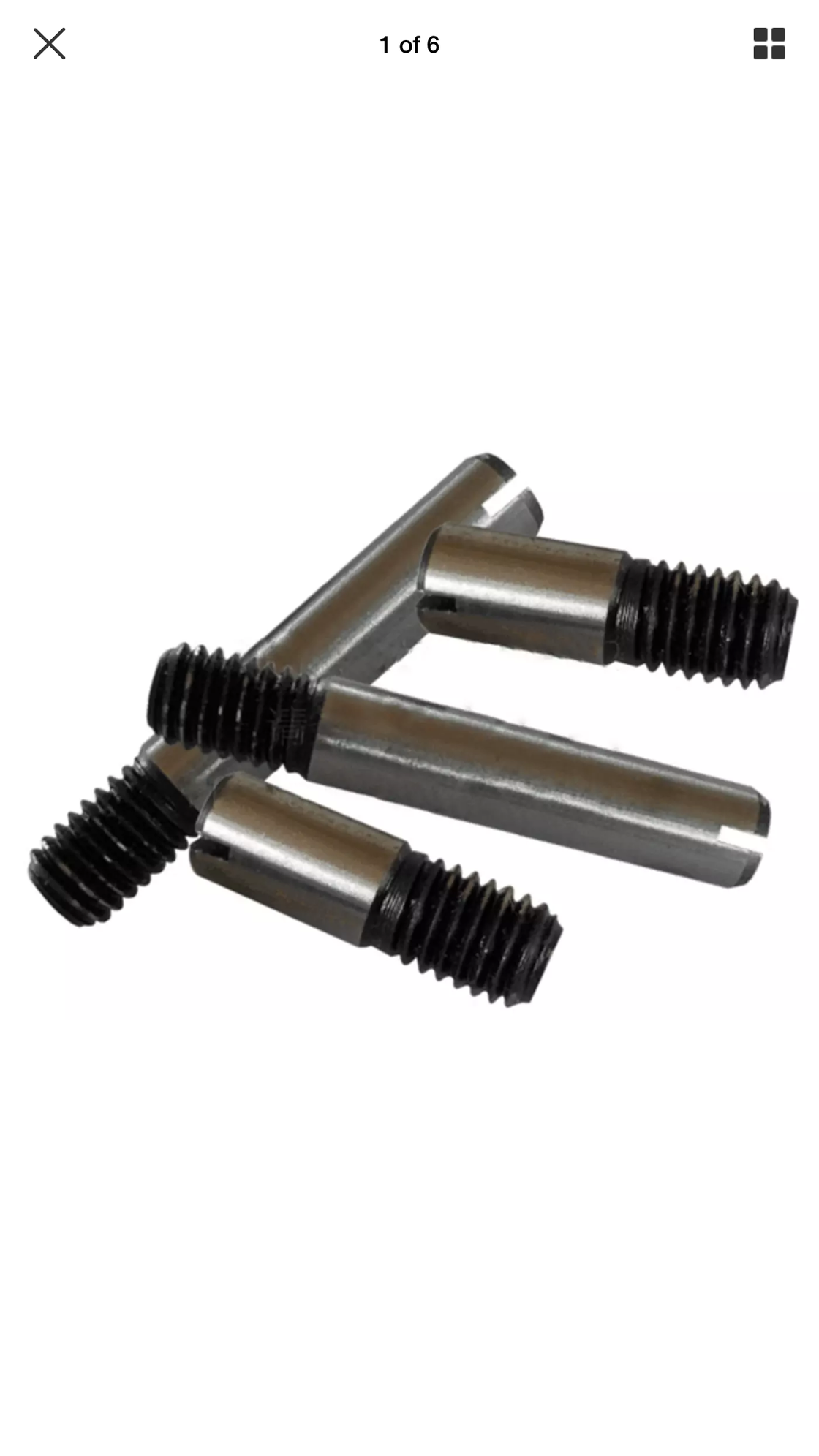

It’s winter, and I think in replacement of actually driving my S I’m spending more time just tinkering with it As such, I just got around to finishing a handmade shift knob for it just for kicks! Maybe doesn’t fit the s2000 interior so well, but I had fun making it

That looks like a cool project I may undertake. Where did you get the threaded insert?

I got a threaded nut adapter from eBay as pictured. I threaded it into a hole just big enough to be threaded in, and fastened it into the knob using wood glue. From there, you can put in a threaded dowel (also pictured) and throw it on a drill chuck to sand it smooth! Currently the knob feels too big. Gonna have to bring it down to more similar to stock knob size.
